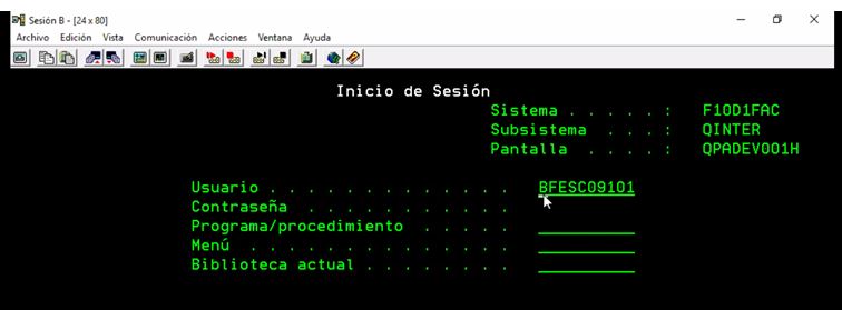

    Posted Feb 02, 2018 11:19 AM
    Hello Ralf,
    OK i understood about the auto login, but in the AS400's login process, is possible to inject other data relationament like how i describe in the image attached?
    This is with the objective to make a transparent login and the user go to the main menu without input that credentials.
    Please look the attached image.
    AS400 Login Credentials
    Thank You So Much!!!
    Adolfo.
  • 7.  Re: Transparent Login with AS400 endpoint CA PAM 3.x
    Broadcom Employee
    Posted Feb 02, 2018 11:34 AM
    Hi Adolfo, I still think you are talking about auto-login, not transparent login. Your login screen seems to be customized, at least localized. In general auto-login should work if you setup an access policy with a target account that has valid credentials. But it's possible that it doesn't work with a customized login page. If that's your problem, you can open a support case and we'll take a closer look.
  • 8.  Re: Transparent Login with AS400 endpoint CA PAM 3.x
    Broadcom Employee
    Posted Feb 02, 2018 12:04 PM
    Actually, if you are asking about whether the PAM mainframe applets can fill in fields other than username and password in the login page, the answer is NO.
