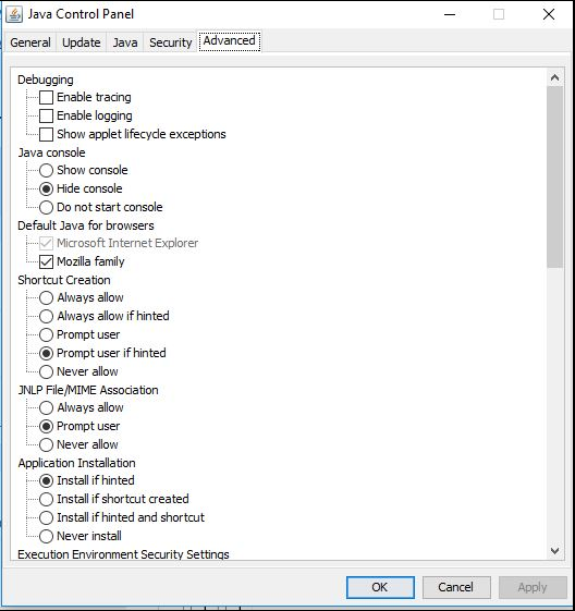

    Can I get some steps on how to enable trace and see the console to see the relevant messages?

    Hi Lakshman, Your screenshot shows the "Enable tracing” flag on top, and the "Show console” flag under the second header "Java console”. These are the two options you want to check. Once the Java console comes up when you log into PAM, which it should if the browser has the Java plugin enabled, you can hit the "5” key (keyboard key for number 5) in the Java console window to raise the debug level. If the Java console never comes up when the flags are set, then your Java plugin isn't working.
