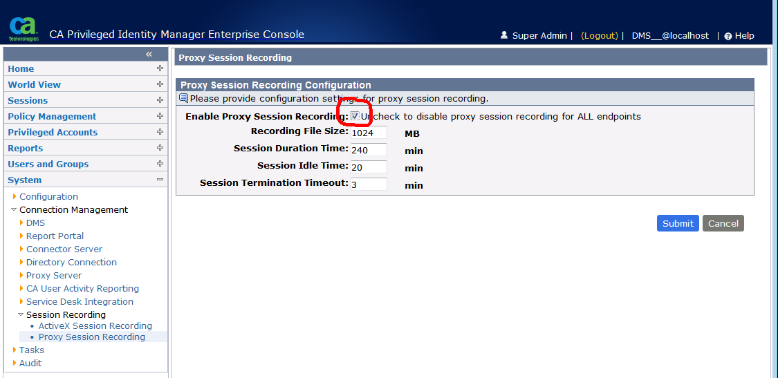

    1. In ENTM, check that "Enable Proxy Session Recording" is checked in System -> Connection Management -> Session Recording -> Proxy Session Recording

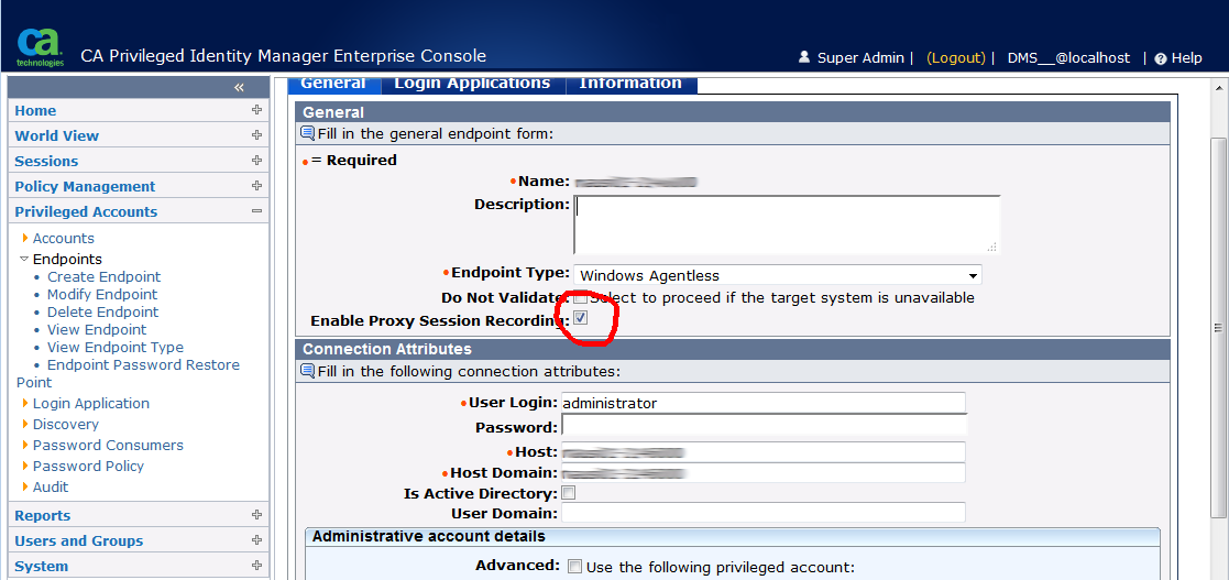

    2. In ENTM, check that "Enable Proxy Session Recording" is checked on the Endpoint, Privileged Accounts -> Modify Endpoint, Search for and select Endpoint.
