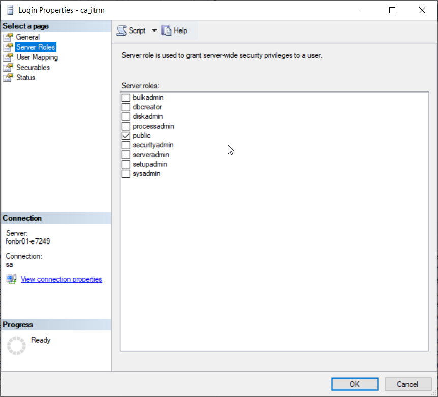

    The problem is likely that the ca_itrm account is running as a SYSADMIN in SQL, which means its operating using the DBO schema, instead of the ca_itrm schema.
    Check your ca_itrm account.
    It should be a public account:

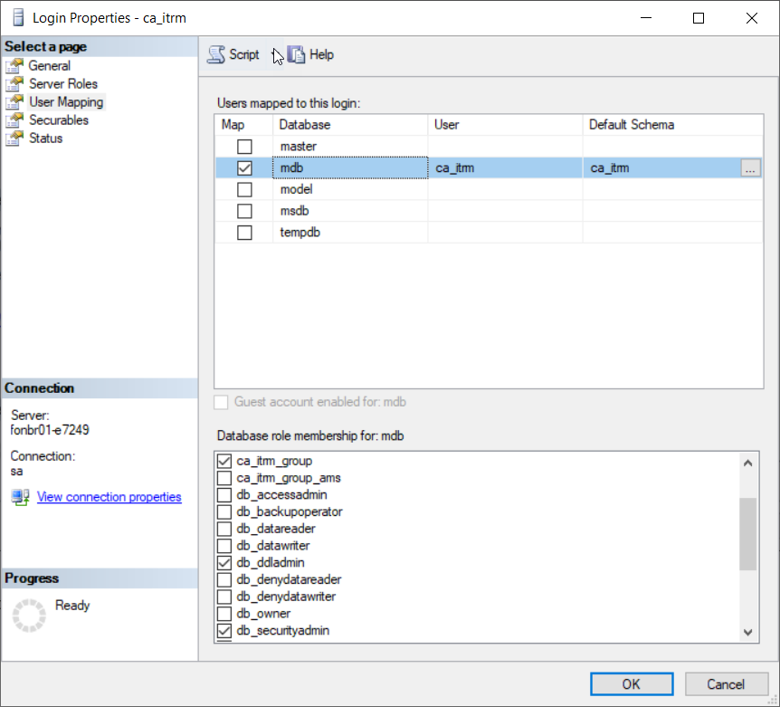

    And it should be mapped to the "mdb" with the "ca_itrm" schema, and have the following role memberships:
    - ca_itrm_group
    - db_ddladmin
    - db_securityadmin
    - public
    After making changes, recycle all of CAF, and re-request FULL inventory from every agent, in order to make up for all the data loss.
