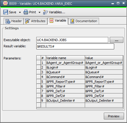

    This was a quicker job than I expected. Here is the generalized EXEC VARA:
    And the corresponding JOBS:

    Note: I use the JOBI to resolve the agent group because PUT_ATT is unable to set the HOST attribute to an agent group.
    This solution is very customizable, but it also means that SCRI that runs this EXEC VARA must set all of the input parameters that the EXEC VARA is expecting.
    :SET &Filesystem# = "/var"
    :SET &Agent_or_AgentGroup# = "UC4.AE_SERVERS"
    :SET &Login# = "UC4.LOGIN"
    :SET &Queue# = "UC4"
    :SET &Command# = "df -h &Filesystem# | grep -v Mounted | sed 's/ \+/;/g'"
    :SET &PPR_ReportType# = "REP"
    :SET &PPR_Filter# = "*&Filesystem#*"
    :SET &PPR_Def1# = "COL=DELIMITER"
    :SET &PPR_Def2# = "DELIMITER=@;
    :SET &Output_Delimiter# =
    :SET &VarHnd# = PREP_PROCESS_VAR(UC4.BACKEND.VARA_EXEC)
    :PROCESS &VarHnd#
    :  SET &Line# = GET_PROCESS_LINE(&VarHnd#)
    :  SET &FreeSpace# = GET_PROCESS_LINE(&VarHnd#,4)
    :  SET &FreePrecent# = GET_PROCESS_LINE(&VarHnd#,5)
    :ENDPROCESS
    :CLOSE_PROCESS &VarHnd#
    :PRINT "File system &Filesystem# has &FreeSpace# (&FreePrecent#%) free space."
    It works like a charm. Enjoy!
