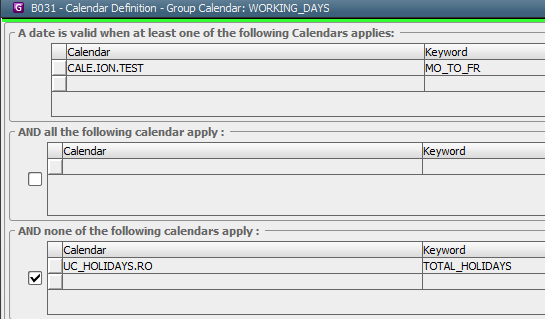

    A weekly keyword in order to get all the days except weekends:
    A Group keyword in order to take out the free days(like holidays) and obtain only the office days:

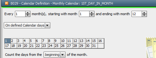

    A Monthly keyword for the 1st day from the month:

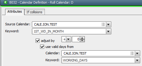

    A Roll keyword in order to get the 1st working day to raport to it:

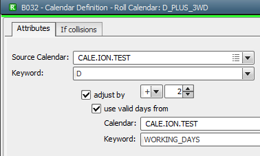

    Another Roll keyword that will be used to add the delayed number of days:
    For example if I need to postpone the executions days with two days, I will adjust it to +2
    The keyword used to schedule jobs on the 3rd working day is:

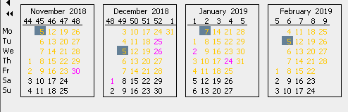

    and the result is :
    If the closing dates are postopned with 2 days, then from D keyword adjusting it with 2 (+2) the result will be:
