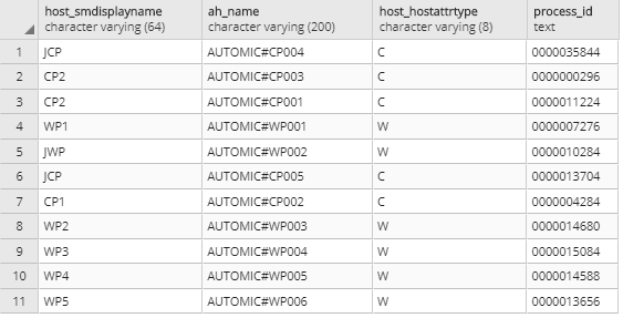

    I did a few adjustments to your query:
    SELECT HOST_SMDISPLAYNAME,AH_Name, HOST.HOST_HOSTATTRTYPE, lpad (AH_ProcessID, 10,'0') PROCESS_ID
    from dbo.ah, dbo.HOST
    where ah_otype = 'SERV'
    and ah_timestamp4 is null
    and ah_oh_idnr = host_oh_idnr;
    And here are the results :
    Tested on PostGre, the syntax might be different on MS SQL / DB2 / Oracle.
    Hope this helps.
