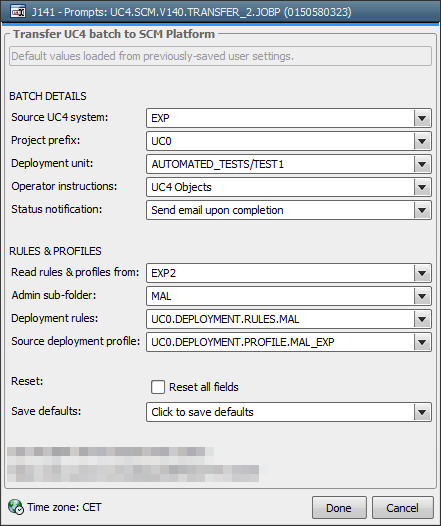

  • 7.  Load default prompt set values from a VARA object using {VARA,KEY,COLUMN} references
    Posted Jan 18, 2017 11:54 AM
    We do this in promptsets quite a bit for environment variables and state variables.  We use both static and SQL variable objects.   But we have never tried it with an EXEC variable object, so your findings are good to know.

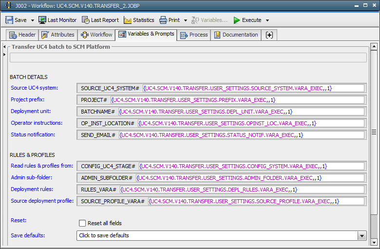

  • 11.  Load default prompt set values from a VARA object using {VARA,KEY,COLUMN} references
    Posted Jan 20, 2017 05:49 AM
    OK, now I’m really in uncharted waters. I thought I might be able to load the initial default values using SQL VARAs.
    o1xsujrios4d.pnghttps://us.v-cdn.net/5019921/uploads/editor/wm/o1xsujrios4d.png" width="1080">
    This does not work as hoped. This sets &Ref_VARA_Defaults# to the first 1000 characters of the SQL query in the referenced SQL VARA. :smile: This works fine if the referenced VARA is a STATIC VARA, so the problem may be limited to SQL VARAs. Moreover, the documentation indicates that variables are allowed in EXEC VARA parameter values. I suppose this is another bug.
    I opened INC00128529 for the problem SEC SQL VARA object references in EXEC VARA parameters not correctly resolved.”
    I will post an update here when I have news.
    Update: I was able to get the SEC SQLI VARA object reference to resolve to a value by omitting the key and column. E.g.,
    {UC4.SCM.V134.TRANSFER.GET_FIRST_PREFIX.VARA_SQL}
    This retrieves the first value from the first key, so it obviously will not work in situations where one wants to retrieve a different  key/value.

    1. A prompt set control that resets all fields
    2. A prompt set control that immediately saves currently-specified values
    1. Reset all fields
    The variable set by this checkbox is not actually used in the parent workflow. However, the checkbox is configured so that any change to it resets most of the other fields in the prompt set.
    The PRPT control elements that were reset are indicated by a thin black surrounding box.

    The combo box is a dynamic control that accesses an EXEC VARA. This VARA runs an SCRI that immediately saves all of the currently-specified values to the static VARA used to save user defaults.
    :READ &SOURCE_UC4_SYSTEM#,,
    :READ &PROJECT#,,
    :READ &BATCHNAME#,,
    :READ &OP_INST_LOCATION#,,
    :READ &SEND_EMAIL#,,
    :READ &CONFIG_UC4_STAGE#,,
    :READ &ADMIN_SUBFOLDER#,,

    The result of saving the values to the static VARA is returned in the combo box pop-up menu.
    This allows the user to save the currently-specified values for next time, even if he plans to cancel the prompt set.
    These are admittedly kludges. If prompt sets offered a simple Button control, these capabilities could be implemented in a more consistent and intuitive way.

    Since a number of bugs related to prompt sets and EXEC VARAs have been fixed in recent service packs, I decided to go back to the original approach and see if it might work. To my delight, I found that the AE is now clever enough to figure out the necessary order of evaluation of prompt set defaults, even when these defaults use EXEC VARAs and depend on other prompt set values that also depend on EXEC VARAs.
    This is the latest version of the prompt set. I opted to create a dedicated EXEC VARA for each prompt set default that needs to be looked up. Originally I did this because reusing the same EXEC VARA led to cross-talk between the processes performing the variable resolution. I suspect that bug has been fixed, but I stayed with this approach to simplify troubleshooting. All of these EXEC VARAs call the same SCRI, but with different parameters. This SCRI in turn collect and assemble the data from other VARAs using GET_VAR. These VARAs are a mix of static, SQL, and EXEC VARAs. In one case, one of the parameters of an EXEC VARA includes a {}-style reference to an SQL VARA. (It’s a bit complicated!)
    The data sources for the fields are similar to the EXEC VARAs used to set the defaults. They simply provide complete lists rather than single items.
    When the workflow is executed, the SCRI is executed multiple times to look up the initial default values for the prompt set elements. If the user has previously executed this workflow, these values are loaded from a user-specific static VARA object. Otherwise, they are loaded in a field-specific way. (E.g., for the Prefix field, if not saved user default is found, the first available prefix is selected as the initial default.)
    I also added a little banner at the top, displaying a message indicating whether or not the default values were loaded from previously-saved user defaults. This too uses the trick of a {}-style reference to an EXEC VARA in the field default. In order to get this to work, I had to use a temporary static VARA to store the message to be displayed*. (This static VARA is written earlier in the process by the SCRI that loads saved user defaults, and if no saved defaults were found, a different message is stored, read, and displayed.)
    The Reset check box simply clears most of the other fields.
    The Save defaults controls immediately saves the currently-selected values to the user’s settings VARA, and displays the result of this operation in the combo box. This way the user can save the settings without actually submitting the workflow.
    I’m glad I finally got this working. It is complicated, but it demonstrates several tricks for running tasks behind the scenes even before the prompt set has been displayed, and building relationships and dependencies between the values looked up by these tasks.

    {UC4.SCM.TRANSFER.LOAD_USER_SETTINGS.VARA_EXEC,SOURCE_SYSTEM,2}
    instead of
    {UC4.SCM.TRANSFER.LOAD_USER_SETTINGS.VARA_EXEC.SOURCE_SYSTEM,,1}
    Unfortunately, this approach comes with a couple of limitations:
    1. In order to use the same EXEC VARA for all the values one wishes to look up, the VARA must load all of these values that may be needed, each time it is called. The filtering by key and column takes place only after the data have been retrieved. Retrieving everything each time and then filtering to just one piece of information seems wasteful and inefficient.*
    2. If a key or column is missing from the retrieved data, a runtime error will occur:
      U00020272 An invalid column (0002) has been specified for reading from VARA object 'UC4.SCM.TRANSFER.LOAD_USER_SETTINGS.VARA_EXEC,SOURCE_SYSTEM,2'.
    This does somewhat constrain the usefulness of this approach.
    Sadly, {VARA,KEY,COLUMN}-style VARA object references are not a true replacement for custom user functions, and the key and column parameters cannot be used as arguments because they are inaccessible to the called object. If you want to pass dynamic pieces of information to the called executable object, there are only two ways to do this:
    1. Pass the information via a script or object variable in the execution context. (And again, such variables are not available in the execution context used for resolution of prompt set defaults.)
    2. Pass the information via a channel external to the execution context, such as via a static VARA.
    If you are willing to create a separate EXEC VARA for each “function call” that you want to execute, this works. It just requires creating a bunch of essentially identical objects that differ only in a few details.
    * One could argue that executing a separate task for each lookup is already quite inefficient!

    One more interesting finding: If I run this workflow but leave all of the default values as-is, the jobs that are used to generate the pick lists for the prompt set combo boxes are executed after I submit the prompt set. I’m not sure why this is. If the menus are never activated (clicked on), I do not know why these jobs would need to be run.
  • 59.  Re: Load default prompt set values from a VARA object using {VARA,KEY,COLUMN} references
    Posted Jun 19, 2018 12:14 PM
    If you’re interested in trying out a workflow that uses the above approach to save and load last-used settings, check out the updated version of my AE tracing workflow.
