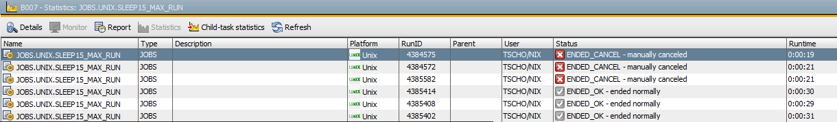

    Using maximum runtime (MRT) of 15 seconds, else cancel, should abort the job:
    6q1431sz8i1x.pnghttps://us.v-cdn.net/5019921/uploads/editor/0w/6q1431sz8i1x.png" width="715">
    However it may happen, that the job is not canceled:
    Let’s think about 2 scenarios:
    1. First Timer take place 5 seconds after job start – MRT still ok.
      Next Timer will be 25 seconds (= 5 + 20) after jobs start. Job is still active and will be canceled, because MRT is violated.
    2. First Timer take place 12 seconds after job start – MRT still ok.
      Next Timer will be 32 seconds (= 12 + 20) after jobs start. Job has finished in the meantime (2 seconds before), so it cannot be canceled, even MRT is violated.
    Note:In addition the timing might also be influenced by the current load of the system.
    Knowing this it is understandable, that maximum runtime setting below 1 minute do not make sense.
