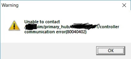

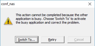

    I have some issues with the Infrastructure Manager App. During any configuration through IM I often receive the following errors:
    Any ideas?

    Posted 13 days ago
    Looks like you are trying to configure controller at the primary hub, typically this will happen with robots under secondary hubs. Ensure there are enough system resources, the latest probe versions, only a handful of robots directly under the primary, no tunnels at the primary. or just try using Admin Console.
