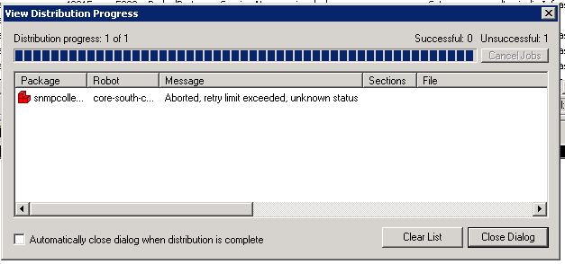

    We are having trouble in deploying the probe SNMPCollector in any secondary hub.
    We already tried to deploy through both IM archive and Admin Cosole.
    The distribution server returns the following error: "Aborted, retry limit exceeded, unknown status"
    And an alarm is also generated: "Max. restarts reached for probe 'snmpcollector' (command = <startup java>)"
    We have all the documentation pre-requisites installed.
    Both versions 3.44 and 3.43 of SNMPCollector returns the same error.

    Dear All,
    This case was solved.
    My archive from Core NMS was corrupted.
    We desactivated the distribution server probe, removed the folder Archive from C: and activated the probe again.
    After all, we were able to distribute the probe correctly.
