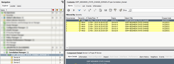

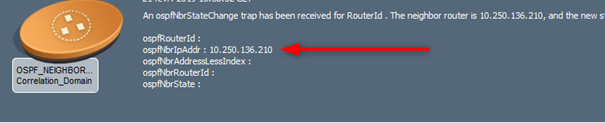

    • Here the first Event from DEVICE A (loss 10.250.136.210)
    • Second Event from DEVICE B (loss 10.250.136.210)
    • The result
    • Event from DEVICE C ... no worry.

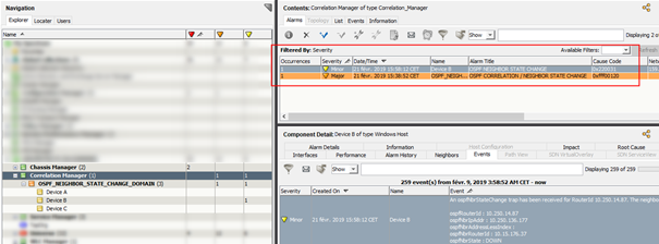

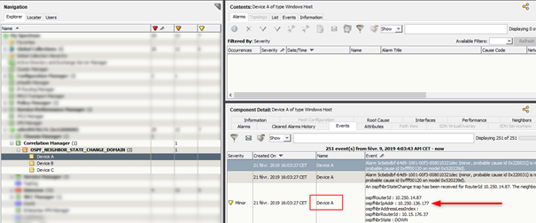

    bellow, 3 new SNMP Notifications for an another router loss (10.250.136.177)
      • DEVICE B
      • DEVICE A (10.250.136.177)
      • I got only one alarm on the OSPF_NEIGHBOR_STATE_CHANGE_DOMAIN with the first IP Address loss 10.250.136.210
      No Alarm for the loss of 10.250.136.177
    Only one alarm

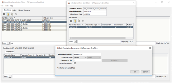

    0xfff00120 and Var Bind 2 (ospfNbrIpAddr) as Discriminator.
    The discrimination did not work and I don’t understand why?

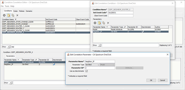

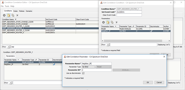

    Bellow how I built the Correlation:
    • Symptom Condition X
    • Symptom Condition Y
    • The root cause è 0xfff00120

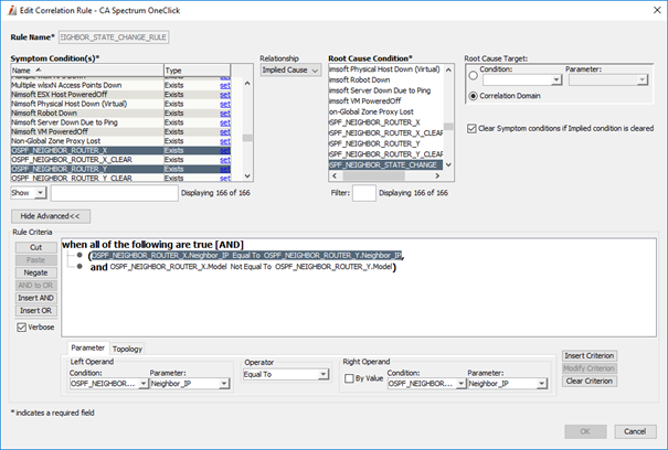

    • The Rule

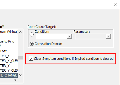

    Furthermore, I add … despite having checked the box “Clear Symptom conditions if Implied condition is cleared” this is not what is happening.
    When the major alarm is cleared on the Domain Correlation, all minor alarms reappear.
