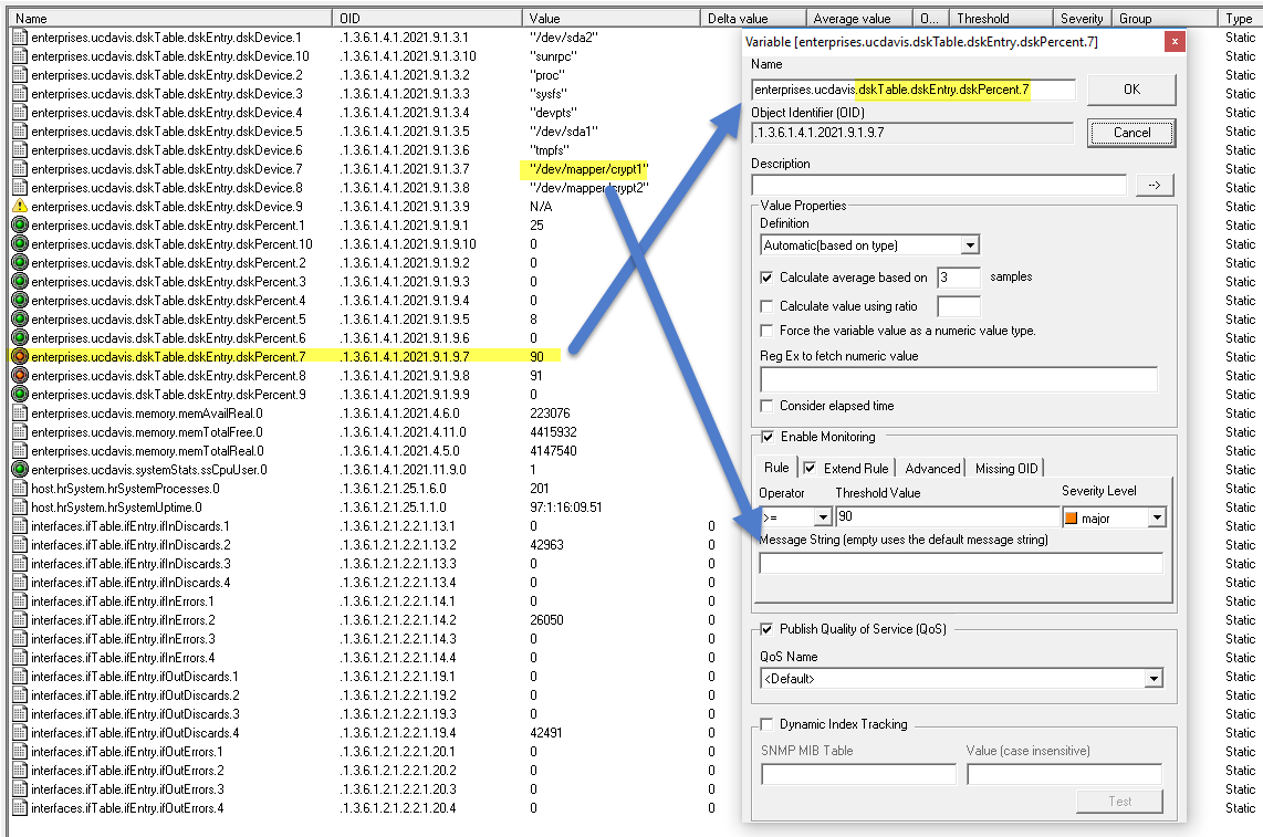

    So I might of missed this and not sure if its possible but looking at a device in snmpget, browsing the device, it has 10 disks and the disk names are in one OID block. The disk usage Percentage value is in another block.
    How do I take the name value in one OID and use it in the Message String for the Alarm in the disk usage percentage OID metric?
    Previously we would just rename the profile/metric OID and then use the $profilename in the Alert Message String but there has to be an easier way right?

    This cannot be done with the snmpget probe, but can be done with the deprecated snmptoolkit probe.
    For the record, both of these probes are replaced with the snmpcollector probe.
