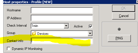

  • 6.  Re: Info of net_connect on db CA UIM
    Posted Apr 22, 2019 03:29 PM
    I think that what @ Stephen Danseglio was trying to say was that the contact info is part of the net_connect profile:
    You could then use this value in an alarm message by using the variable $contactinfo in the message for the profile.
    Presumably, if you included this data in a predictable way you could then later extract it in an alarm enrichment or AO profile.
    -Garin
