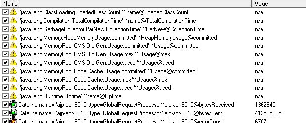

    Tomcat Probe not able to gather values for few Metrics.
    After configuring the Tomcat probe to connect to the servers through jmx port, lot of the metrics value are 'n/a' below are the few examples
    Other monitoring tools are able to gather the information through jmx, don't know if I am missing some setting on the tomcat probe.

    Note: From the support case it was noted that the problem metrics were old metrics from Jre6 that were depricated in Jre8 which is why they did not have values.
