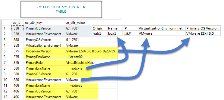

  • 3.  Re: SQL Query to pull all ESX Host and their VMware version
    Broadcom Employee
    Posted Oct 05, 2018 03:07 AM
    attached screenshot

  • 5.  Re: SQL Query to pull all ESX Host and their VMware version
    Broadcom Employee
    Posted Oct 10, 2018 01:15 AM
    It was just found in google searching "table row pivot rotate"
  • 6.  Re: SQL Query to pull all ESX Host and their VMware version
    Broadcom Employee
    Posted Oct 10, 2018 01:19 AM
    You are almost correct. If ccsa.cs_attr_key = HypervisorVersion then return value, otherwise return NULL.
    In this example, "where clause" is important. Without it, it populates HypervisorVersion as NULL for most devices.
