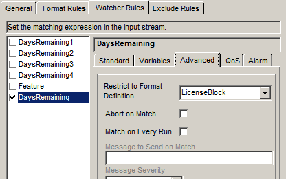

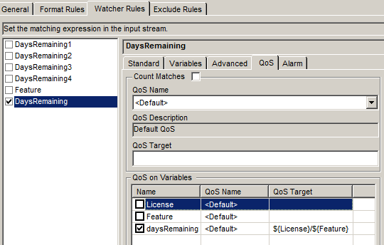

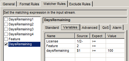

    This was my attempted setup:
    When I test the profile it has no results.
