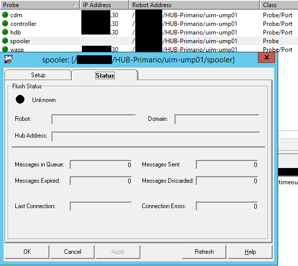

    I'm observing that the spooler probe of the ump robot has its Flush Status as Unknown.
    Inside the spooler and controller logs I don't see errors that could indicate some problem.

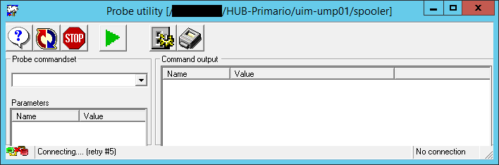

    Into the probe utility of spooler probe shows no connection, trying to conencting without success.
    Both HUB and UMP are in the same network. No firewall between them.
    I restarted the nimsoft service on the ump side, without success.

    Can you go to the nimsoft directory and see if you have a hub directory there. I can see this situation when some one by mistake deploy the probe hub and after that the spooler never works fine. You must delete the hub directory and redeploy de spooler probe by update robot.
    Also you can open the controller on this UMP check installed package to see if the hub probe is listed there.

    I replaced the spooler probe from the update version option, I marked the checkbox Replace existing probe.
    Once the process ended, I can see again the spooler probe in a normal condition.
