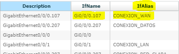

    If I need that the alarm of type interface from snmpcollector probe contain in the message the "IfAlias" is possible?
    Interface of a device where the IfAlias contain name.
    We need that the alarm contain the name "CONEXION_WAN"
    Best Regards.

    Unfortunately, it is not possible as of now.
    I think it is a great idea for future enhancement.

    Unfortunately there is not possible to make ifAlias take part of snmpcollector alarms.
    You may want to vote this existing Idea
