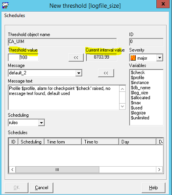

    I have monitoring db sql 2014 with sqlserver probe, but for some reason not arrive alarm to usm

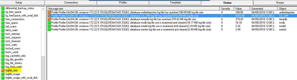

    The status of the profile in the probe indicate that a checkpoint reached the threshold.

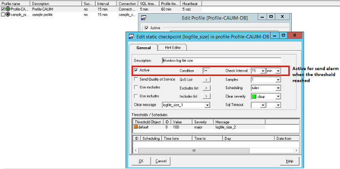

    The configuration to this checkpoint "logfile_size" is:
    Need I make other configuration?

    Check under this
    sqlserver IM Configuration - CA Unified Infrastructure Management Probes - CA Technologies Documentation
    i.e. Setup tab and check field 'Generate Status Only' if this is selected no alarms trigger and by default it is selected.
