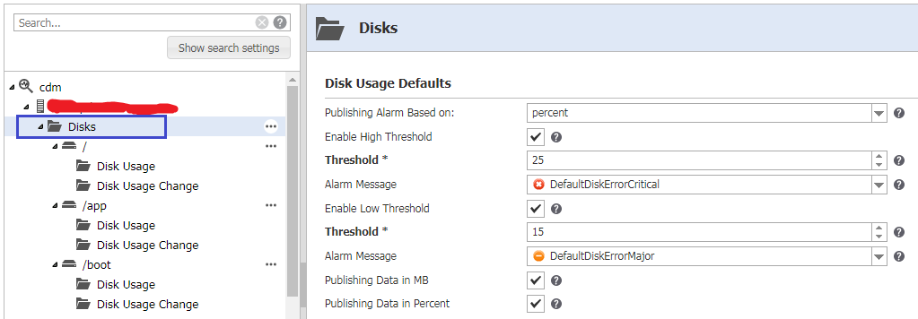

    I am not using the Disk Usage setting under a disk partition/mount point. If I go with that configuration, I need to configure thresholds at each Disk partition/Mount Point level. Which is a pain for me to follow this procedure on 2000+ servers.
    I am using the Disk Usage Defaults as shown in the below screenshot which should enable default monitoring on all the available disks along with the new Disks added later to the configuration.
    What is the best practice to apply the same set of rules (Static/dynamic) for CDM monitoring on multiple servers without configuring each disk partition/mount point? I don't see anything related to this in the documentation.

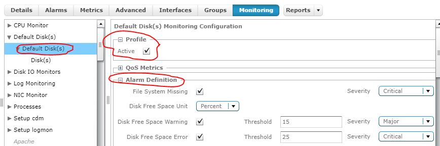

    If I enable the default monitoring on a device using MCS (UMP/USM), it is enabling the data collection as well along with the thresholds configured for default monitoring. I can use this MCS profile on group. Whereas, the default configuration through Admin Console is not activating the configured thresholds and QOS data collection might be due to there is no option to activate it. This is a pain here.
    I do not prefer MCS default monitoring as it is not having the option to configure dynamic thresholds. To configure dynamic thresholds even using MCS, I have to create a profile for each mount point/Disk Partition and apply to the group having the same mount point/Disk partitions names. Otherwise, the servers not having the partitions will generate alarm stating the disk is missing.

    If you would like to configure similar configuration on many servers then suggest you follow the MCS option via USM
    ->Agree this is still work in progress  , but many features for MCS including dynamic thresolds are going to be enhanced in upcoming UIM 9.0 release
    https://docops.ca.com/uimp90beta/how-to-articles/configuring-alarm-thresholds-in-mcs
