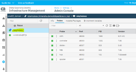

    In Admin Console, select the hub and then probes to see if the discovery_agent probe is there and activated.

    We checked for the same and we are not able to see any kind of discover_agent probe is deployed or running in hub.
    Can you please let me know how will deploy discovery agent on this relay hub and how this discovery issue will be fix.
