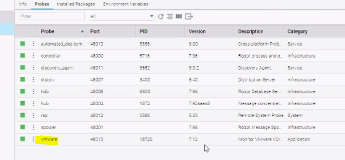

    Hi All Experts,
    We have installed relay hub, VMware probe is running on hub robot.
    MCS profile is also created, all the VCentre VM/ Hosts are discovered and visible in inventory, also we enabled all the metrics, but not able to fetch QOS data for any of the device.
    Can you please suggest why this behavior is happening?
    Also let me know how we will do rename of  any MCS profile.

    Posted Dec 04, 2018 04:34 AM
    Hi David,
    We checked with below URL, as you shared.
    VMware probe Error Failed to execute - max query - CA Knowledge
    What we found that there was a missing hostname entry of the host on which VMware is running in the /etc/hosts file, because it wasn’t resolving via DNS.
    vware probe version 7.12, DXI IM SaaS.
    Firstly we do deactivate vmware probe, after that we update the hostname entry of the host on which VMware is running in the /etc/hosts file,then we do activate the vmware probe.
    Now probe status is showing up and running
    But still the issue is same there is no change!
    Do you have any more suggestions on this?
    Regards
    Dharmender Singh
