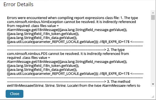

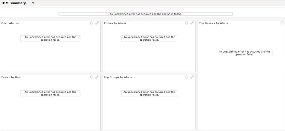

    In my environment, CABI Jaspersoft is setup using cabi probe of CA UIM. I need to migrate the contents of this Jaspersoft to another server where Jaspersoft is setup using CABI Jaspersoft 6.3 installer. When I am exporting the contents of UIM CABI in a zip file (using export everything option) and importing that content to another server, the customized reports are running fine but out of box reports and dashboards like Alarm Summary, Device Summary etc are not running giving errors as shown below:
    Open Alarms Report Error
    UIM Summary Dashboard Error
    Kindly provide the solution for this.
