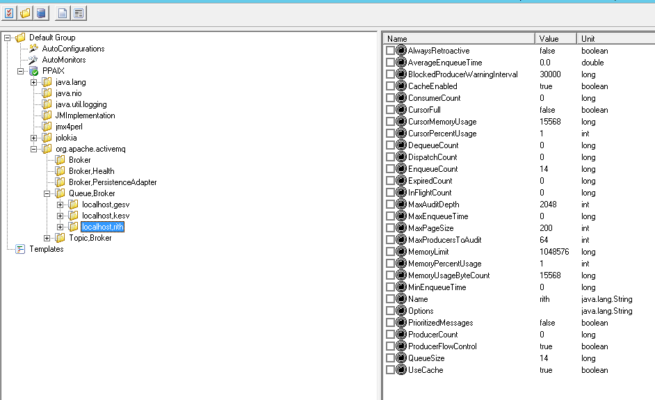

    5. Now open up your Tomcat or JVM-probe and add the host with port 1099.
    • Default User/Password is admin/admin (you should change this later).
    6. When it's connected, it should look something like this:
