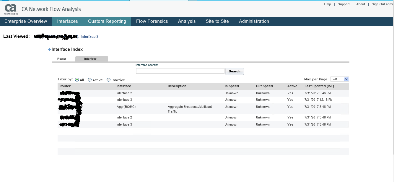

    When we logged in NFA Console>Interfaces>Interface Index>Interface
    In Interface Column we are able to see interface 2 interface 3, why it is not auto sync??
    In Speed showing unknown.
    Out speed showing unknown.
    Why they are showing unknown??
    Let assume we have 2 interface named Gig 0/1, Gig 0/2, why we are getting Interface 2 & and interface 3??
    why we are not getting actual interface name automatically??

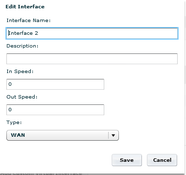

    Manually we can change the Interface name from here
    Is there any setting, that we are missing to get actual interface details by default, rather then interface 2 & interface 3 by default??

  • 2.  Re: NFA Interface Query
    Posted Jul 31, 2017 09:58 PM
    This information is updated using SNMP, you need to have a snmp profile created and assigned to the device to have the interface speed updated in NFA
