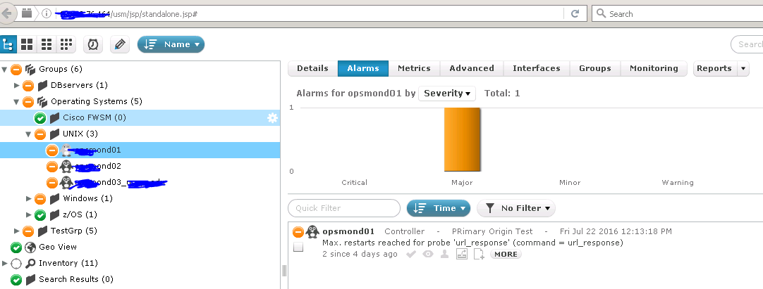

    Apologies I confused our environments. This issue is happening in our 8.2 production not out 8.4 dev. In our 8.4 dev environment, alarms clicked from any list view or anywhere else will open correctly into a new USM alarm view.
    Notice below how they open correctly when I double click from a list view into a new usm alarm window for that specific alarm.
    Where our production would take me to the "alarm console" portlet with the "https://UMPaddress.edu/alarmconsole/jsp/standalone.jsp "  address. Now it's just an error saying "The page you are trying to view cannot be shown because it uses an invalid or unsupported form of compression."

    Whether I tried to open this in IE, firefox or chrome, this should NOT be re-directing me to "https://umpip.edu/ALARMCONSOLE/jsp/standalone.jsp ". I really don't understand how upgrading a production environment to a higher UIM is suggested resolution for this issue.
    IE goes to blank page. But Chrome opens the image below (so did firefox up until last week, then I got the error mentioned)
