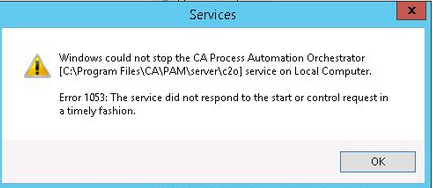

    I try to stop the ITPAM service and get this error:

    The SLF4J errors are normal and can be ignored.  And the error you get when stopping the service can happen and seems to be a java problem.  But regardless neither of those would cause PAM to not work.
