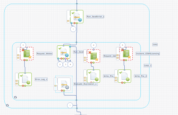

    I have 3 operators which crates ticket, all of them are running in a loop . they trigger separately on the given condition .
    But when i have to go for next record in the loop , i am unable to determine that how can i make the process to wait for until all three should complete there task before going for the next loop ..
    You can refer to the screen shot .
    please help

    You don't explain the exit points from the first operator in the group.From the screen capture it looks like the links to 2, 3, and 4 were all followed. Is is true that that will all be followed or will it sometimes be only one or two of the links will be followed?

    Good morning Kunal.gaurav,
    If I well understood, I think that you can control that using AND/OR operators.

    I have used custom ports to define end point on each operator to trigger the other operator which worked ,
    Because i my case i had generate tickets using the values yes or no conditional input  for each operator and custom port fulfill my requirement to complete the task
