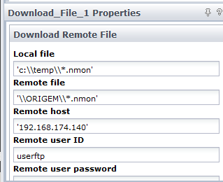

    I need create a process that upload multiple files with FTP protocol.
    I trying use the Upload Operator, but in this case the operator transfer one file by execution.
    It's possible to use this operator to transfer multiple files at the same operator?
    Sample: transfer *.log files
    Its possible or the way is use a script operator to make it?
    I trying this way, but is not working.

    The "download file" operator uses the ftp "get" command which only allows for transfer of 1 file at a time.
