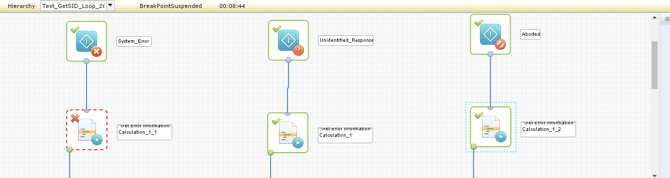

I am using the sample Exception Handler that comes with the SDM process definitions. They trap 'System_Error', 'Unidentified_Response', and 'Aborted' exceptions.

But what I am finding is that this works as designed when the operator has no Post_Execution code to process the web services response. The Reason is 'Service Operation succeeded. Fault returned' and the Fault Message is: soapenv:Client 1010, which is expected for a bad SID and is returned from the Operation Results.
However, it is not working when there is Post_Execution code. Instead, the error that is trapped is the Aborted type and reported by the System Results and the Reason is usually 'msg.valuemap.unexpected.field.type' - because the web service call failed and so the assignment fails because the response is empty. However, when I look at the Operations Results, the Fault Message is still the same 'soapenv:Client 1010'.
The Aborted handler script is:
Process.exceptionType = "Aborted"
Process.source = Process.Aborted.source
Process.errorMessage = Process[Process.source].Reason
It doesn't matter if it is the standard SOAP operator or the SDM Custom Operators.
So, I'm trying to figure out why this is the case that the 'Aborted' is handled instead of the 'Unidentified_Response' when the latter occurs first. Are all the faults evaluated before the handler picks them up?
