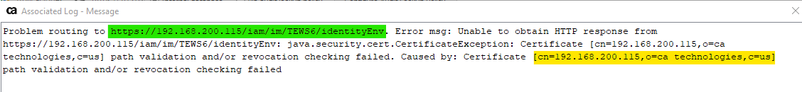

Problem routing to https:IP/iam/im/TEWS6/identityEnv. Error msg: Unable to obtain HTTP response from https://IP/iam/im/TEWS6/identityEnv:

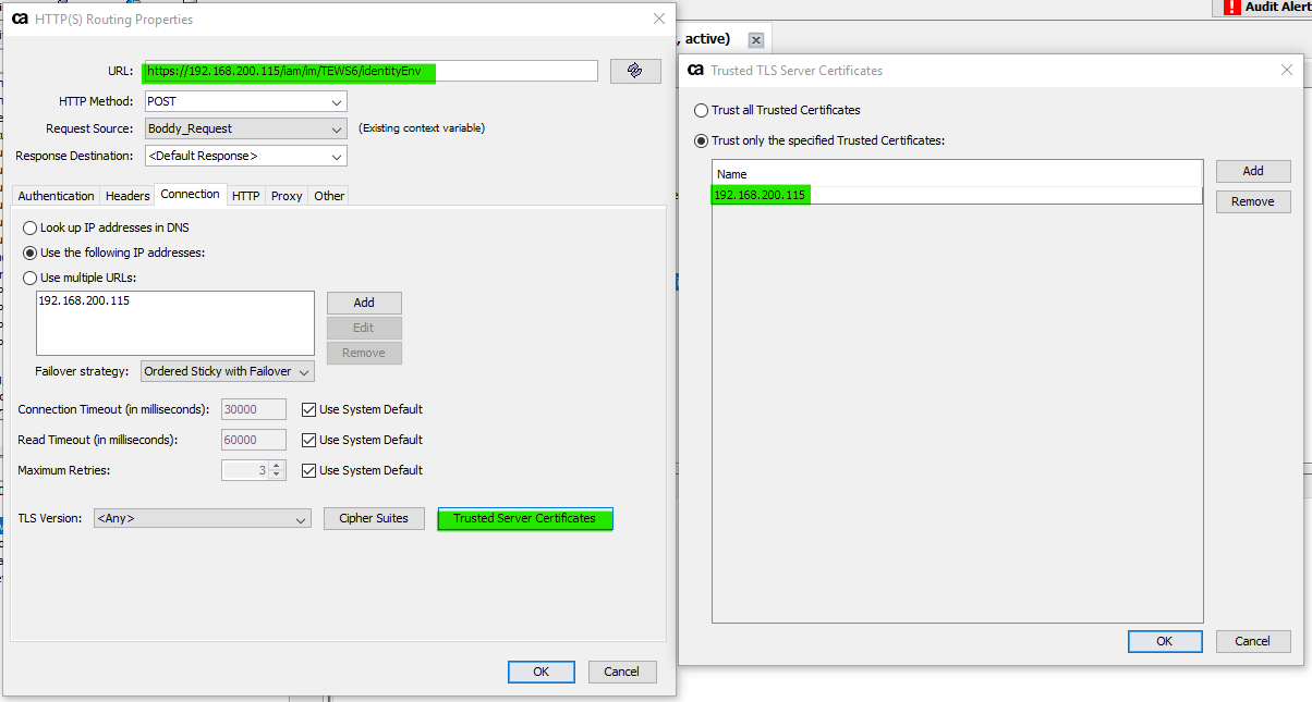

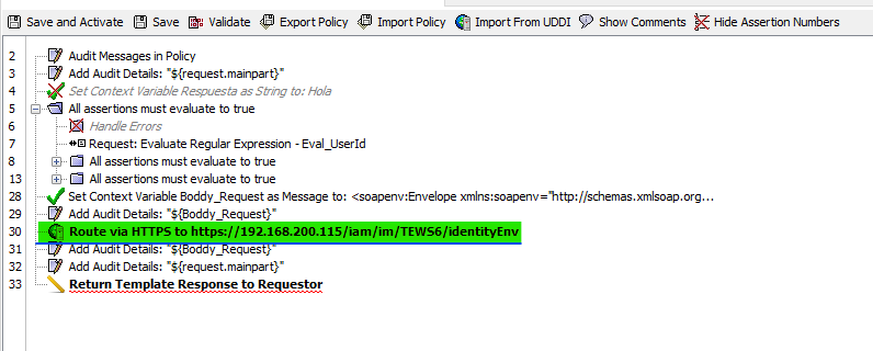

    I'm doing the integration of an Identity Manager webservice in the CA API Gateway, but when redirecting the service to the IDS url, I get an error with the IDS certificate, even though I import it. the imported certificate is the one that generates IDS during the installation since for now I am developing in a development environment
    Any ideas about what I may be doing wrong or how I can access the IDS webservice without validating the certificate?
    this is the error
    this is the assertions
    Import the certificate at API

    Is the certificate still valid? Also make sure, that it is set as "Certificate is a Trust Anchor" in the Validation setting.
    What is the revocation checking for this certificate?
