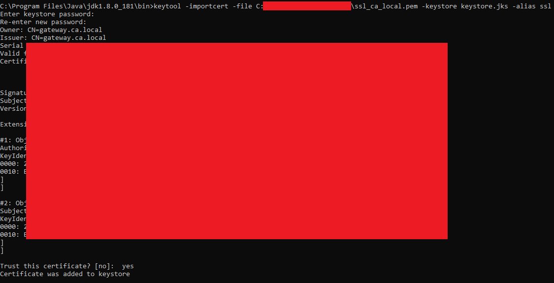

    Using GMU for the first time and I'm stuck still trying to export the services from source gateway. Details are shown below, and images and some infos were partially covered for security reasons (you never know...):
    source.args
    host=gateway.ca.local
    username=admin
    password=<admin password>
    port=9443
    results=results.xml
    encryptionPassphrase=<passphrase>
    trustHostname
    trustCertificate
