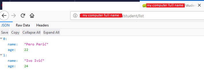

    I have simple Java REST service running on: http://localhost:8080/student/list

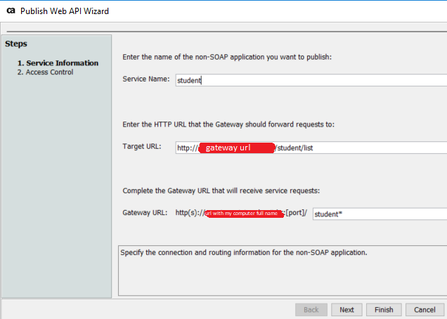

    I am trying to publish it through CA API Gateway:
    This is call from browser target URL:

  • 4.  Re: Publish localhost API
    Posted Oct 19, 2018 02:36 AM
    now I get this:
    and why is in PDF Documentation this:
    I assumed because of that that I must write it as "/student/*" and not "/student*"
    However, still doesn't work in both cases...

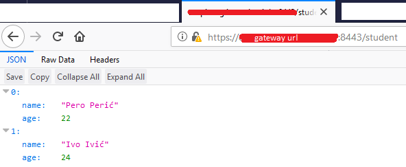

    Posted Oct 22, 2018 08:02 AM
    I added inbound rule in my Windows Defender Firewall for 8443 port for gateway and also added outbound rule with 8085 port for my localhost REST app. I tried to call my localhost REST app service with my computer domain name, but no success!
    Then I changed my REST app port on 80, and tried to call localhost REST app with my computer full name and it works.
    I added this URL with my computer full name in gateway and published Web API service and I finally got response:
    response:
