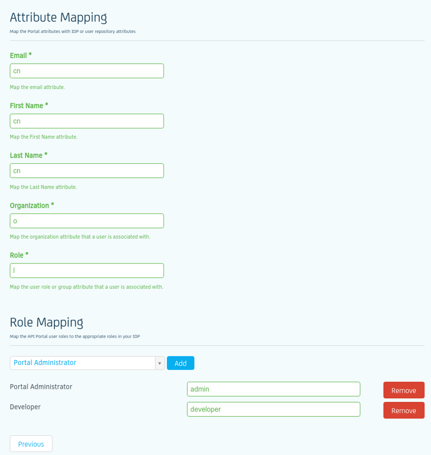

    When using LDAP Authentication Scheme, it only provides mappings for user attributes.If I want to authenticate a user as Portal Administrator, I have to map the user "role" attribute as "title" and the role mapping for a Portal Administrator as "admin", so that a user with "title=admin" can log in as admin. But it just maps a role to an user.

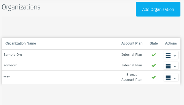

    1) that you will need to have an organisation created for the user that logs in, otherwise it will not allow you to log in.

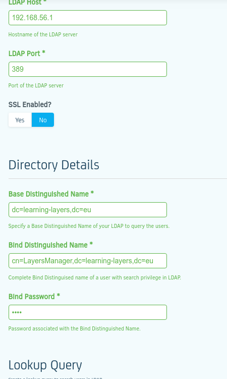

    here is an example of the setting for LDAP
    As you can see, I am reusing LDAP fields so that all will go through and in the Organisation I have 'o' ,
    in ORGANISATIONS I have

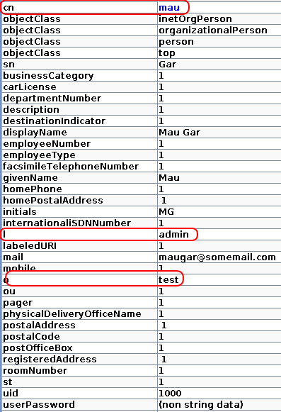

    and in the LDAP I have the following user:
    As you can see I use 'o' for the organisation but I HAD to create it manually in the portal under the 'Organisation' page,
    I hope this helps

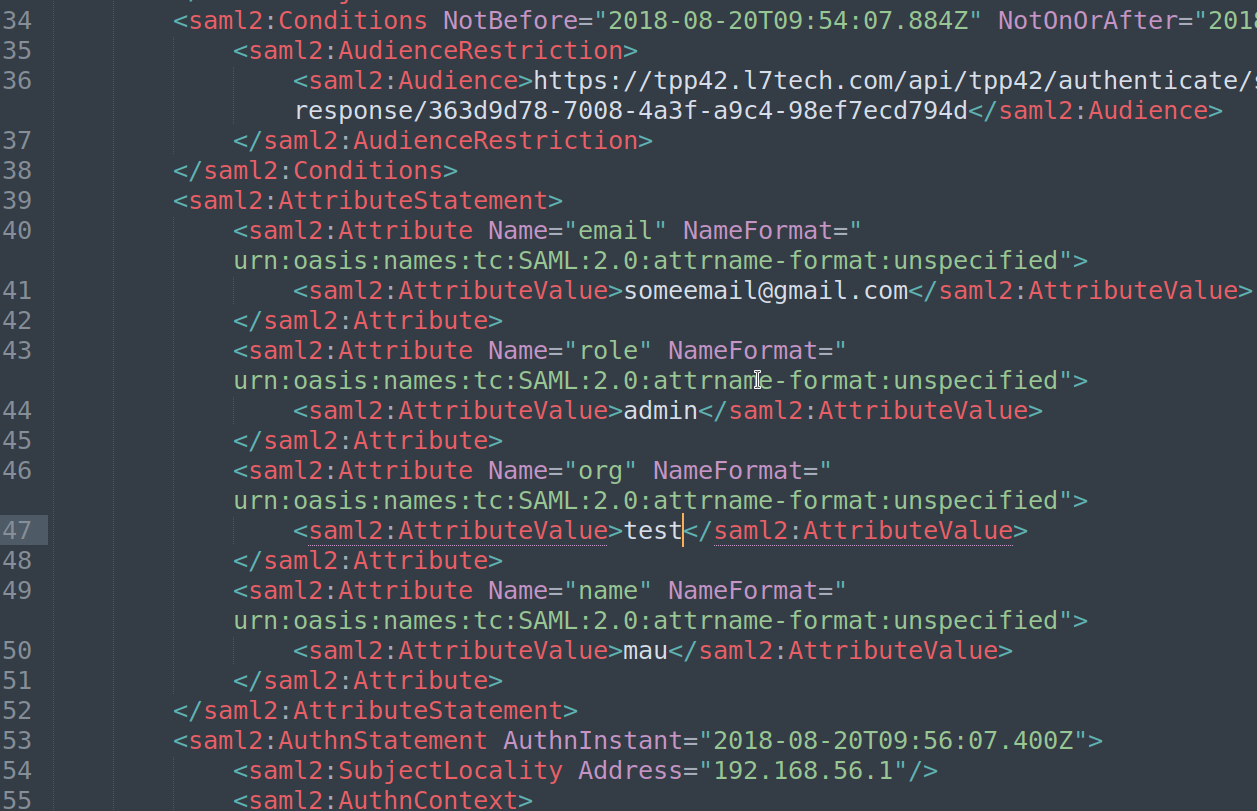

    For SAML, here is a sample SAML response that works
    I hope this helps
