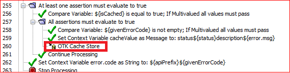

    Approach 1 : Override message creation in "OTK Fail with error message"
    Approach 2 : Capture error message in "Global Message completed" and modify format

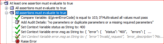

    Approach 3 : Able to modify error message for each status code in customizations/#OTK Fail with error message
    Challenges :
    1. challenges in Approach 1 : how to disable "OTK Cache Store" and override error.msg context variable.
    2. challenges in Approach 2 : Unable to get error message as part of ${response.mainpart} or ${resp.mainpart} and unable to expose as  "Export Variables from Fragment" in customizations/#OTK Fail with error message.
    3. challenges in Approach 3 : Have to override all error code policy assertions, which is not a good practice.
    I failed to achieve even though, was trying to modify "#OTK Cache Look Up Customization / "#OTK Cache Store Customization" . Please share your inputs.

    I would not recommend Approach 1  and modifying OTK Fail with error message directly. To  disable caching of error messages completely you can copy the "isCached" context variable to the top of "#OTK Fail with error message" and set its value to true which will cause cache logic you show at line 255 to not cache error messages.
    Approach 3 is the recommended approach and will persist upgrades.

    I am able to disable cache but unable to modify/customize error.msg. Is there any way to get ${error.msg} inside "#OTK Fail with error message" or "Global Message completed"?

    ${error.msg} is set further down in the "OTK Fail with error message" assertion. TO override all OOB error messages you would need to copy all the error handling branches to "#OTK Fail with error message" and modify them accordingly.
