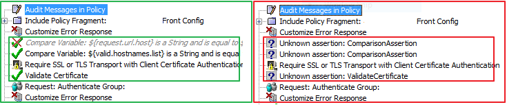

    Hello everyboy!
    Suddenly this problem appeared
    Very common gateway assertions have disappeared...
    In the logs we can saw this messages errors
    2018-03-07T10:47:14.181+0100 WARNING 1 com.l7tech.server.policy.PolicyCacheImpl: 3255: Policy "# Front Config" (#6e8b96726be8704f940c4672fdb06b5e) contains an unlicensed assertion: Unknown assertion: ValidateCertificate
    With the support of "CA Support", we have reinstalled licenses several times, but the error persists.
    Can anybody help me?
    Thanks!

    Does the assertion still exist/work in policy manager? Is it only the validate certificate assertion?
    We have seen similar issues for other assertions typically during the gateway startup but not affecting functionality. There is no special licensing needed for this assertion that I am aware of(Aside from the normal Gateway license).

    Since the beginning of time, in the middle age when the installation was made, the error for this assertion was presented only RetrieveOAuth2Token:

    Much later it began to appear for other more common assertions, such as:
    Validate Certificate, Compare Expression, Split Variable, among others...
    I think you can not see the image that I loaded in the initial post.
    But I said no, the assertions disappeared from the assertion palette and all the policy fragments where they were included appear with an icon with a question mark and with the message "Unknow assertion: ..."
    Unknown assertion

    Thank you, those screenshots did not show int he original post for me, that definitely makes things clearer. The RetrieveOAuth2Token issue was a known problem even in the latest 9.3 Gateway but does not affect functionality (Known Issues - CA API Gateway - 9.3 - CA Technologies Documentation ).
    However, I've have only see something like this in the palette when the time is out of synch on the Gateway. Assuming the time is correct (not ahead or back dated in any way) you may want to open a support time so we can investigate further.
    If you are running a 9.2+ Gateway a copy of the DCT output would be idea for us to review.

    I have resolved 'unknow assertion' issue while granting r-r-r permission to all assertion under below location
    /opt/SecureSpan/Gateway/runtime/modules/assertions.
    follow below steps.
    1) login to each node with ssh and change to above directory
    2) chmod 444 *
    3) Restart gateway process
         service ssg restart
                or
    option 2 from main menu then 7 from then 1( start the gateway )
    Note : assertion .aar file permission should be like below on all nodes in a cluster.
    -r--r--r--. 1 layer7 layer7 108689 Aug 18 2017 ComparisonAssertion-9.2.00.aar

    Hello dasjo02 , udareddy and everybody!
    We have restored the servers!!!
    The results are the following:
    Node 1 (SRV02374) = NOK
    Node 2 (SRV02375) = OK
    I have stopped the service of node 1 but it is necessary to continue investigating what is the problem and what caused it.
    dasjo02 I will work with the DCT... and then I will tell you the results!
    udareddy then the result of the command "ls -ls" on both nodes...
    The good one...

    The bad one...
    [root@srv02374 assertions]# pwd
    [root@srv02374 assertions]# ls -ls
    total 86172
       96 -r--r--r-- 1 layer7 layer7    90919 Dec 14  2016 AdaptiveLoadBalancingAssertion-9.2.00.aar
     1888 -r--r--r-- 1 layer7 layer7  1926921 Mar 21 11:14 ApiPortalDataLensAssertion-9.2.00.aar
      680 -r--r--r-- 1 layer7 layer7   692072 Mar 21 11:14 ApiPortalIntegrationAssertion-9.2.00.aar
       28 -r--r--r-- 1 layer7 layer7    28157 Dec 14  2016 BufferDataAssertion-9.2.00.aar
      100 -r--r--r-- 1 layer7 layer7    96549 Dec 14  2016 BulkJdbcInsertAssertion-9.2.00.aar
       56 -r--r--r-- 1 layer7 layer7    52679 Dec 14  2016 CacheAssertion-9.2.00.aar
     7064 -r--r--r-- 1 layer7 layer7  7218738 Dec 14  2016 CassandraAssertion-9.2.00.aar
       12 -r--r--r-- 1 layer7 layer7    11377 Dec 14  2016 CertificateAttributesAssertion-9.2.00.aar
      112 -r--r--r-- 1 layer7 layer7   108660 Dec 14  2016 ComparisonAssertion-9.2.00.aar
       28 -r--r--r-- 1 layer7 layer7    25813 Dec 14  2016 ConcurrentAllAssertion-9.2.00.aar
       32 -r--r--r-- 1 layer7 layer7    31642 Dec 14  2016 CORSAssertion-9.2.00.aar
       24 -r--r--r-- 1 layer7 layer7    23611 Dec 14  2016 CsrfProtectionAssertion-9.2.00.aar
       12 -r--r--r-- 1 layer7 layer7    11721 Dec 14  2016 CsrSignerAssertion-9.2.00.aar
       16 -r--r--r-- 1 layer7 layer7    12544 Dec 14  2016 EchoRoutingAssertion-9.2.00.aar
       44 -r--r--r-- 1 layer7 layer7    41387 Dec 14  2016 EncodeDecodeAssertion-9.2.00.aar
       80 -r--r--r-- 1 layer7 layer7    73876 Dec 14  2016 EsmAssertion-9.2.00.aar
      120 -r--r--r-- 1 layer7 layer7   118207 Dec 14  2016 EvaluateJsonPathExpressionAssertion-9.2.00.aar
        8 -r--r--r-- 1 layer7 layer7     5241 Dec 14  2016 FtpCredentialAssertion-9.2.00.aar
       72 -r--r--r-- 1 layer7 layer7    66402 Dec 14  2016 FtpRoutingAssertion-9.2.00.aar
    56708 -r--r--r-- 1 layer7 layer7 58005292 Dec 14  2016 GatewayManagementAssertion-9.2.00.aar
       36 -r--r--r-- 1 layer7 layer7    33703 Dec 14  2016 GenerateOAuthSignatureBaseStringAssertion-9.2.00.aar
       20 -r--r--r-- 1 layer7 layer7    17255 Dec 14  2016 GenerateSecurityHashAssertion-9.2.00.aar
       12 -r--r--r-- 1 layer7 layer7    11491 Dec 14  2016 GenericIdentityManagementServiceAssertion-9.2.00.aar
     1096 -r--r--r-- 1 layer7 layer7  1116109 Dec 14  2016 IcapAntivirusScannerAssertion-9.2.00.aar
       44 -r--r--r-- 1 layer7 layer7    42807 Dec 14  2016 IdentityAttributesAssertion-9.2.00.aar
       64 -r--r--r-- 1 layer7 layer7    60872 Dec 14  2016 JdbcQueryAssertion-9.2.00.aar
       24 -r--r--r-- 1 layer7 layer7    20835 Dec 14  2016 JsonDocumentStructureAssertion-9.2.00.aar
       32 -r--r--r-- 1 layer7 layer7    31920 Dec 14  2016 JSONSchemaAssertion-9.2.00.aar
       76 -r--r--r-- 1 layer7 layer7    73068 Dec 14  2016 JsonTransformationAssertion-9.2.00.aar
       92 -r--r--r-- 1 layer7 layer7    88747 Dec 14  2016 JsonWebTokenAssertion-9.2.00.aar
      500 -r--r--r-- 1 layer7 layer7   505284 Dec 14  2016 JwtAssertion-9.2.00.aar
       24 -r--r--r-- 1 layer7 layer7    22536 Dec 14  2016 KerberosAuthenticationAssertion-9.2.00.aar
       60 -r--r--r-- 1 layer7 layer7    56349 Dec 14  2016 LDAPQueryAssertion-9.2.00.aar
       16 -r--r--r-- 1 layer7 layer7    14182 Dec 14  2016 LookupDynamicContextVariablesAssertion-9.2.00.aar
       32 -r--r--r-- 1 layer7 layer7    30764 Dec 14  2016 ManageCookieAssertion-9.2.00.aar
       16 -r--r--r-- 1 layer7 layer7    15314 Dec 14  2016 ManipulateMultiValuedVariableAssertion-9.2.00.aar
       32 -r--r--r-- 1 layer7 layer7    30344 Dec 14  2016 MessageContextAssertion-9.2.00.aar
      272 -r--r--r-- 1 layer7 layer7   271962 Dec 14  2016 MqNativeAssertion-9.2.00.aar
       80 -r--r--r-- 1 layer7 layer7    75239 Dec 14  2016 MTOMAssertion-9.2.00.aar
      492 -r--r--r-- 1 layer7 layer7   498715 Dec 14  2016 NcesDecoratorAssertion-9.2.00.aar
       20 -r--r--r-- 1 layer7 layer7    19549 Dec 14  2016 NcesValidatorAssertion-9.2.00.aar
       24 -r--r--r-- 1 layer7 layer7    20953 Dec 14  2016 NtlmAuthenticationAssertion-9.2.00.aar
     1076 -r--r--r-- 1 layer7 layer7  1095731 Dec 14  2016 OdataValidationAssertion-9.2.00.aar
       80 -r--r--r-- 1 layer7 layer7    73785 Dec 14  2016 PolicyBundleInstallerAssertion-9.2.00.aar
       48 -r--r--r-- 1 layer7 layer7    45725 Dec 14  2016 PortalBootstrapAssertion-9.2.00.aar
     4536 -r--r--r-- 1 layer7 layer7  4631448 Dec 14  2016 RadiusAssertion-9.2.00.aar
       48 -r--r--r-- 1 layer7 layer7    48621 Dec 14  2016 RateLimitAssertion-9.2.00.aar
      216 -r--r--r-- 1 layer7 layer7   215878 Dec 14  2016 ReplaceTagContentAssertion-9.2.00.aar
       64 -r--r--r-- 1 layer7 layer7    58484 Dec 14  2016 RetrieveServiceWsdlAssertion-9.2.00.aar
       36 -r--r--r-- 1 layer7 layer7    35531 Dec 14  2016 SamlIssuerAssertion-9.2.00.aar
      508 -r--r--r-- 1 layer7 layer7   513553 Dec 14  2016 SamlpAssertion-9.2.00.aar
       44 -r--r--r-- 1 layer7 layer7    42436 Dec 14  2016 SimpleRawTransportAssertion-9.2.00.aar
       84 -r--r--r-- 1 layer7 layer7    79832 Dec 14  2016 SiteMinderAssertion-9.2.00.aar
      332 -r--r--r-- 1 layer7 layer7   333345 Dec 14  2016 SnmpTrapAssertion-9.2.00.aar
       28 -r--r--r-- 1 layer7 layer7    25694 Dec 14  2016 SplitJoinAssertion-9.2.00.aar
     1516 -r--r--r-- 1 layer7 layer7  1547157 Dec 14  2016 SshAssertion-9.2.00.aar
     2052 -r--r--r-- 1 layer7 layer7  2093428 Dec 14  2016 SwaggerAssertion-9.2.00.aar
       24 -r--r--r-- 1 layer7 layer7    22198 Dec 14  2016 UDDINotificationAssertion-9.2.00.aar
       12 -r--r--r-- 1 layer7 layer7    10241 Dec 14  2016 UUIDGeneratorAssertion-9.2.00.aar
       16 -r--r--r-- 1 layer7 layer7    15961 Dec 14  2016 ValidateCertificateAssertion-9.2.00.aar
       20 -r--r--r-- 1 layer7 layer7    16397 Dec 14  2016 ValidateNonSoapSamlAssertion-9.2.00.aar
     3872 -r--r--r-- 1 layer7 layer7  3957805 Dec 14  2016 WebSocketAssertion-9.2.00.aar
       48 -r--r--r-- 1 layer7 layer7    47910 Dec 14  2016 WsAddressingAssertion-9.2.00.aar
      364 -r--r--r-- 1 layer7 layer7   366279 Dec 14  2016 XacmlPdpAssertion-9.2.00.aar
      132 -r--r--r-- 1 layer7 layer7   130583 Dec 14  2016 XmlSecurityAssertion-9.2.00.aar
      772 -r--r--r-- 1 layer7 layer7   785092 Dec 14  2016 XMPPAssertion-9.2.00.aar
    Thanks and Regards,
    REAL
