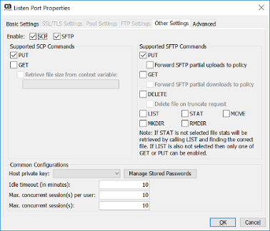

    1.  To handle the inbound SFTP message, configured an internal SSH server running on a CA API Gateway listen port using the "SSH2" protocol

    2. Does the Gateway support a LIST, PUT and GET commands for SFTP? I can see that my first request is a "LIST" for which I get the error as shown above. When configuring the SSH2 listener, I have enabled LIST, PUT and GET but I am not sure if there is something I need to learn/understand here.

    1. When I connect using the SFTP client (WinSCP in this case), I get the following error:
    Error listing directory '/'
    Response: The gateway does not expose the local file system through the Gateway application. You would need to connect to another source to pull the data. We see a lot of people using SFTP to SFTP on another server so the gateway is a bridging mechanism between or SFTP to S3 buckets.
    Response: Yes it supports these commands plus more.
    3. What should I do to save a PUT command when the client tries to send a file?  I assume that will be available as part of the request.mainPart context variable
    Response: Correct any file sent in will be stored in the request message context and can be accessed through the normal means.
    4. Where does the the physical file reside once the gateway receives it? Does the Gateway has means of storing it in dedicated SFTP folders/directories? I can see that the current SSH path is "/" - is it possible to have custom paths
    Response: As the file system is not exposed through the JAVA application, the information pushed or pulled through the gateway is held in memory as it executes the policy.
    5. Is it possible for the SSH request received to have an AD based authentication instead of the Internal Identity Provider?
    Response: You can connect to any LDAP provider or Authentication system that can validate user/password combination or certificates.
