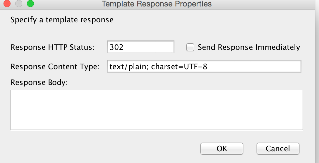

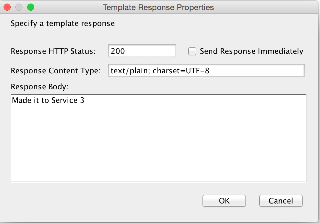

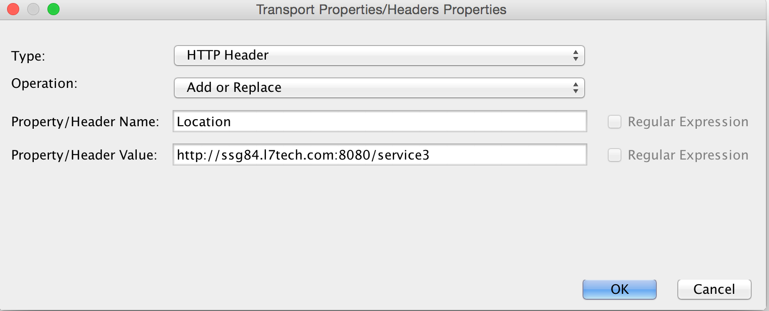

    You still haven't shown us anything in regards to Policy or what you are receiving from the backend?....
    I have set up a Test Case.
    I have Service1, Service2, and Service3

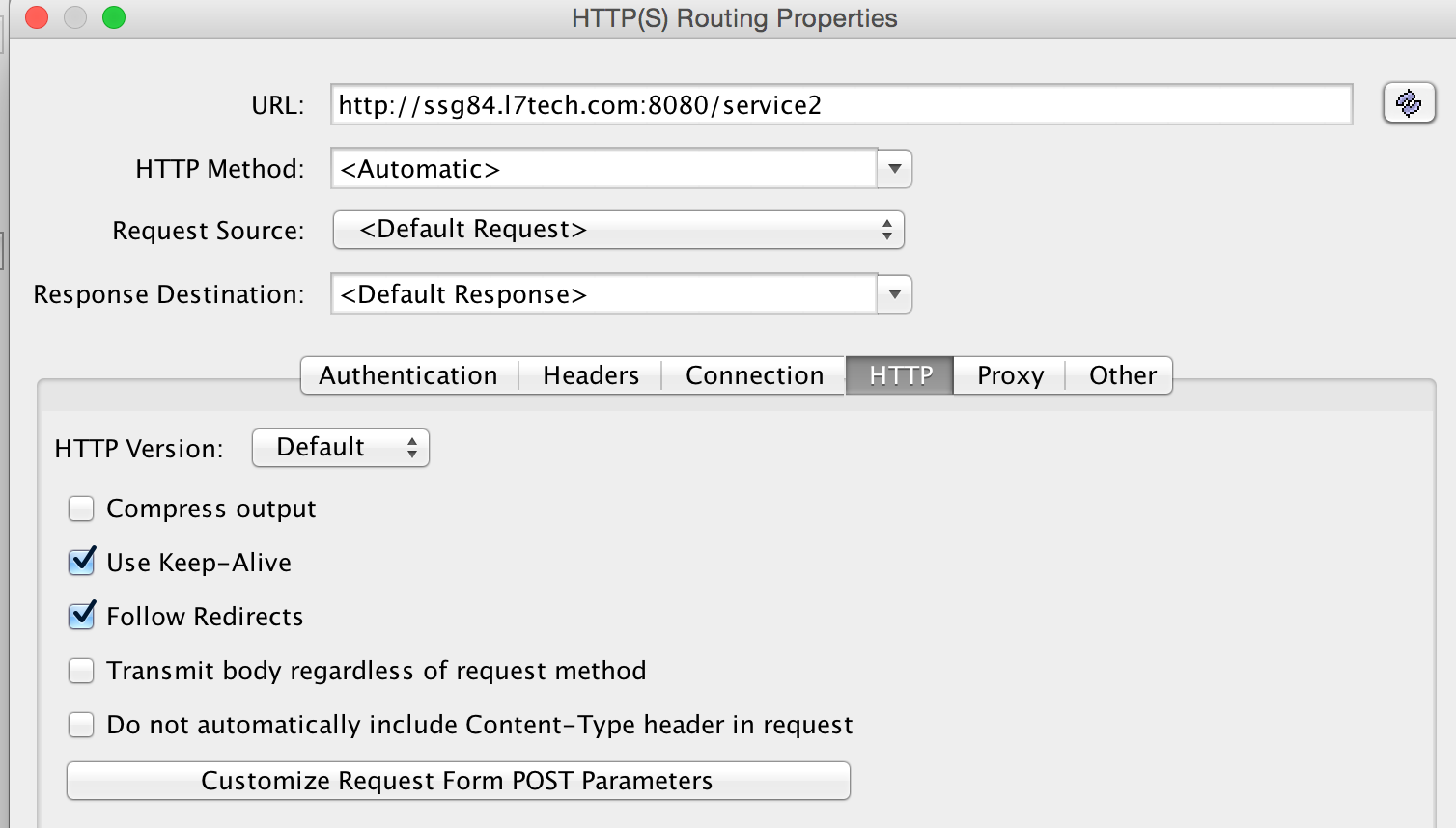

    Service1 contains the following Route statement. ( Routes to Service2 w/ redirect option checked )
    Service2 Adds the Location header and Returns a 302 HTTP Status Code.
    Service3 Returns a 200 and a Success Message.

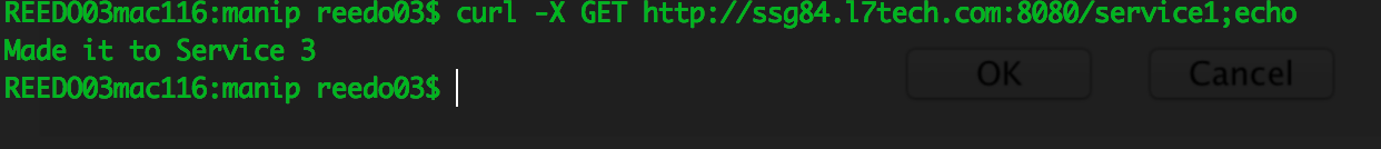

    Here is me calling Service1, which called service2 and got a 302 redirect to service3.
    Just for kicks and giggles, lets have another redirect in there. ( service3 will direct to Service4 ).
    this worked too.
    This led me searching for common problems people face when redirects aren't happening as they would expect.
    i came across Redirects failing when the HTTP Method of 'POST' was used.
    i verified this with my test above, POST didn't work. I got it to work by modifying Service1's route to Explictly use a 'GET' method instead of Automatic.
    So, i dug a little further and saw that the HTTP Spec doesn't consider POST methods 'Safe' for obvious reasons and doesn't require the user-agent to automatically follow redirects in situations of 'unsafeness' without letting the user know. Since we aren't in a web browser, we just don't follow them.

    I done more tests base on your example, and found some interesting results,
    1. in service1, set the HTTP method of Route via HTTP assertion from <Automatic> to GET, the redirection will be successful no matter what method is specified for curl.
    2. set 'Pass through only certain request/response headers' of Route via HTTP assertion (not include Location header), the redirection will fail for curl. (ie. block Location header either on request or response)
    It's quite different if I use a REST client plugin of firefox to call service1,
    3. the redirection will be successful even when I set the HTTP method as POST.
    4. the redirection only fail when I set both 'Pass through only certain request headers' and 'Pass through only certain response headers' and all exclude Location header.
