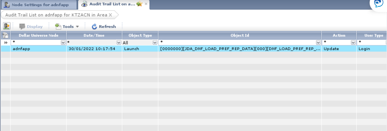

    This morning I checked the audit trail again for this node, and somehow, it is only showing up audit log from yesterday, and not all of the other logs (I chose all jobs and all dates) - see screenshot below.  Is there any issue somewhere?  The setting shows 90 days log is kept as I sowed in previous comment.  Please advise further.  Thanks again.

    Hello Gerry, there should be more data in u_fmat60.dta than this...
    what is the size of the file?
    if your node is on version 6.10.x you could use the command uxlst audit and display its content via the command line
    else, that would mean that your u_fmat60.dta file has either beein reinitialized or that it's way too big and when you try to display its whole content the uxioserv would allocate a lot of memory and be busy trying to read all the file content.

    Hello Gerry, the audit trail data file (u_fmat60.dta) exists on each area subfolder of the node, like every other production data file, you have the full list here
    Hence, please look inside the folder data/exp and count how many lines the file has (using wc -l u_fmat60.dta for example).

  • 8.  RE: Who deleted a uproc
    Posted Feb 01, 2022 09:25 AM
    My mistake, thank you Adrian for your time again.  The size is, 1,101,648 bytes, with 778 lines.  Is this too big?  Does this mean it is not being purged?

  • 9.  RE: Who deleted a uproc
    Broadcom Employee
    Posted Feb 01, 2022 11:21 AM
    Hi Gerry, the file is very very small, just 1MB my friend and only 778 lines.
    It means that there is pretty much almost nothing on it, it is indeed being purged.
    Usually, this file has a size of a couple of hundred MBs, specially if you use command line like "uxpur ctl", "uxdlt evt" or some other commands to create objects/launches like "uxadd fla" or "uxordre".
    Anyhow, if you can't see anything from UVC, means that if there was a record, it must have been already purged.
    Feel free to open a case if you want so that we can take a look at the uxtrace of the node.
