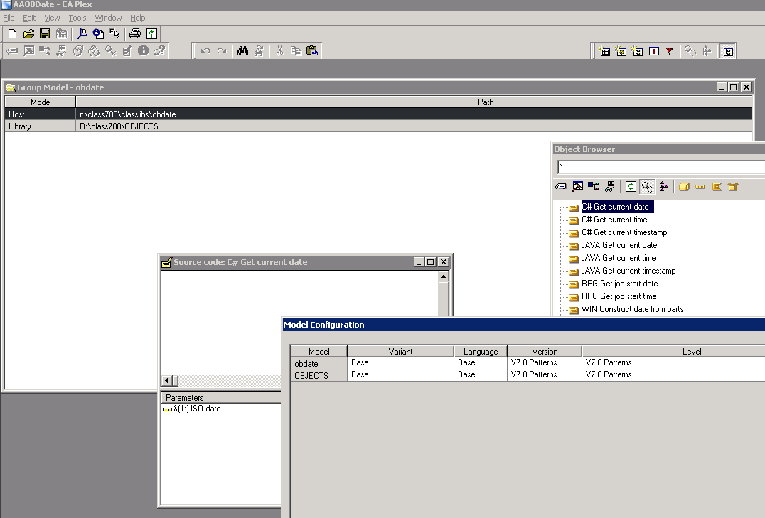

    While I am waiting to get my CA profile updated so I can open a case with CA Support, I figured I would ask if anyone knows a hack to update the OBDATE group model since this is a reference model sent with the CA Plex releases. The correct source code for OBDATE/C# Get current date, OBDATE/C# Get current time, OBDATE/C# Get current timestamp is in the .Net Server variant, however, setting the OBDATE variant to .Net server messes up the C++ client functions since the Meta Validation functions are Internal (OBDATE/Validate ISO Date, OBDATE/Validate ISO time).. and with the variant set to .Net Server the lang sys triple for the validation functions is set to C# (WinC client calling Internal C# does not cut it).  I checked and the OBDATE Source code for all the other combinations (JAVA, RPG,WIN) were coded in the Base Variant, just seems the C# were coded in the .Net Variant by accident and not in the Base.

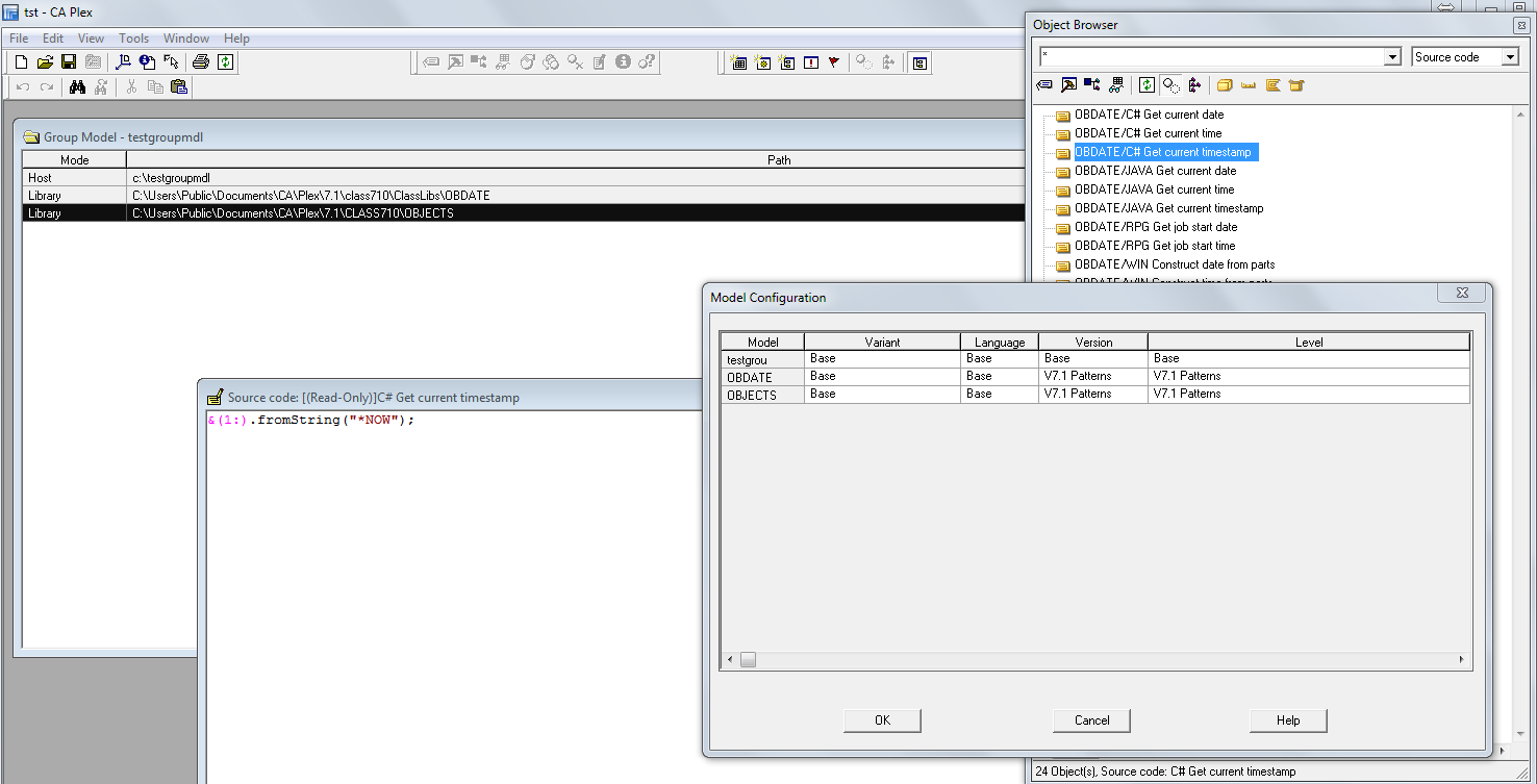

    What version of Plex are you using ? A short test with Plex 7.1.26.005 shows
    that the source code is in the base variant for C#.
    Cheers

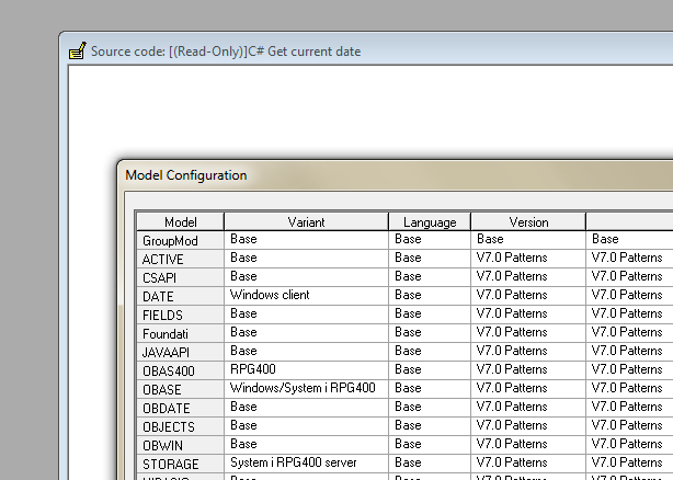

    but not 7.0 in the sample model RPGIV_DEMO
    But I would like to hear from Diane what actually is the problem as I think it is alright for a winc panel to call the C# interrnal as you get a warning but as long as the obdate library is built in winc mode the build works fine as it picks the object up from your lib file

  • 9.  Re: OBDATE/C# Get current date, OBDATE/C# Get current time, OBDATE/C# Get current timestamp Source code in Base Variant is missing
    Posted May 20, 2016 04:39 PM
    We are using V7.0 Patterns.. so must be that they have fixed it.. Great to know that it is fixed in a future release.. Maybe I won't need that hack after all..
