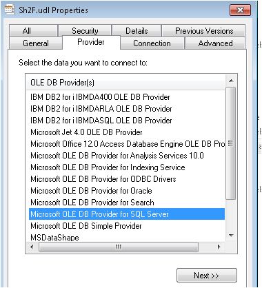

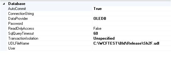

    Understood on the Config file - I can connect  - however I get different results when using the date/time fields depending on the combination of driver I use - so I get date errors using one driver and connection issues using the other
    on my DEV pc -
    Trusted Authority to the SQL DB  = Yes
    Plex Config File: Specifes a udl file
    the udl file Uses the SQL Native driver and specifies Integrated Security
    in this setup I can read and write/update records with DateISO/Time ISO values
    If I switch the udl file to use the OLE DB provider - the data will read & update but I get Errors
    'plex999 - Specified cast not valid and 'No Data Exists for the row column
    the ONLY thing changed here was the provider in the UDL file

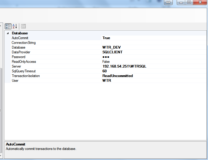

    If I switch this to the SQLCLIENT in the PLEX config file - the plex connects using the usr/pwd in the config file  - but will not connect using my user/pwd that I use on my PC as it is a Domain/User accoun
    if I take this same code to our shared DEV environment  - that we do NOT have integrated security to we need to specify a Specific user to connect to the SQL Database - I cannot use the udl file as we cannot save the Password
    if I switch to SQLCLIENT in the Plex config file - I can get the client to connect and display the data rows  - including Date/Times - however  - I get data conversion error when Updating the rows - Even though I have checked the values of the dates immediately prior to update and  they are valid (and they update correctly in scenario 1 above)
    just trying to determine the best combination (or restrictions that exist)  when using which driver as pertaining to the date/time operations

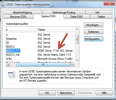

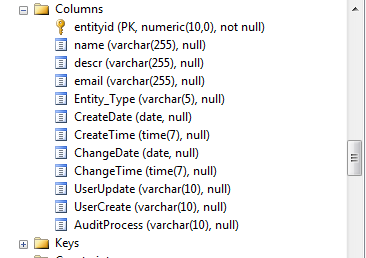

  • 14.  Re: Trying to Configure the UDL file for C#
    Posted Aug 11, 2014 11:29 AM
    Wayne,

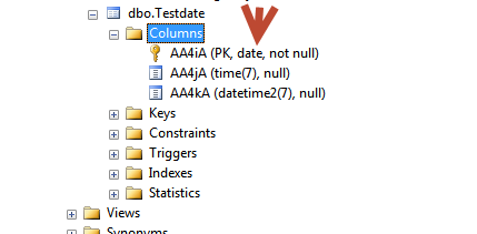

    so your date and time fields are created like this :
    using Plex to create the table via ODBC :
    Result in SQL Server
    I am asking this, because older ODBC drivers will create "datetime" types for each iso date or iso time.

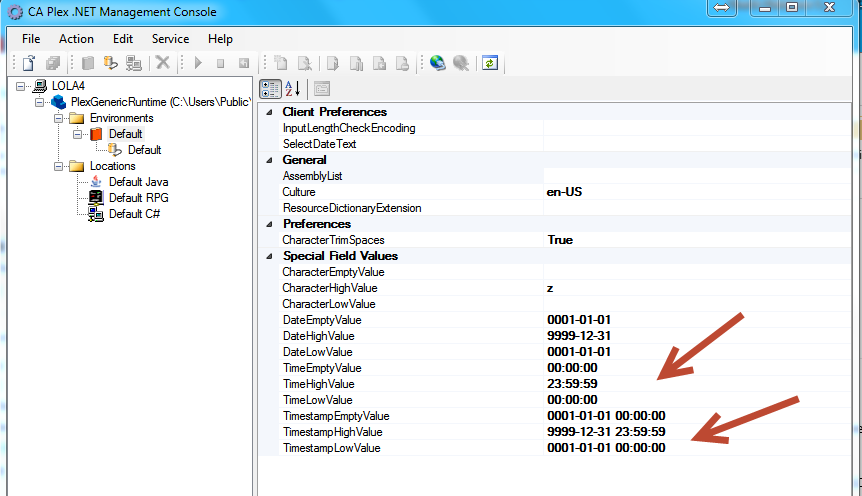

    There are two other areas to look into:
    What is the db  configuration used in the .exe.config file and wht is the culture used ?
    is it like this ?
  • 15.  Re: Trying to Configure the UDL file for C#
    Posted Aug 11, 2014 11:58 AM
    All match your details above with the following Exceptions..
    we did not build this table using Plex as it was part of another System - however the data types in SQL match the plex generated ones (date & Time not datetime)

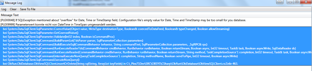

  • 16.  Re: Trying to Configure the UDL file for C#
    Posted Aug 11, 2014 02:39 PM
    Wayne -
    are you getting this error ?   Cannot convert DateTime to TimeSpan ?  There seems to be a bug in the runtime....
  • 17.  Re: Trying to Configure the UDL file for C#
    Posted Aug 11, 2014 02:43 PM
    Yes - When Using the SQLCLIENT -  that is the Error I get when I am trying to perform an Update or Insert of a record - reading the data does NOT appear to generate that error
  • 18.  Re: Trying to Configure the UDL file for C#
    Best Answer
    Posted Aug 12, 2014 04:37 AM
    Wayne -
    I opened a support ticket with CA regarding this problem. (21897411-01)
    Hope we will have a fix for this soon.
    Best
    Lorenz
