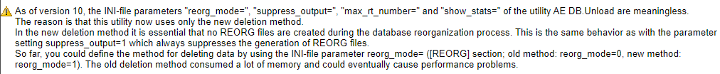

    True, in the .ini file this parameter is missing but if you check the documentation of the DB Unload utility you will see it. LINK
    It was pointed to me by the Vendor Support Engineer as we also had some issues with the Unload back in the days.
    Moreover the other parameters as "suppress_output" , "reorg_mode" are obsolete since v10. You can keep it in the ini or remove it. It doesnt matter anymore.
