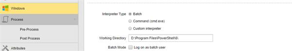

    Maybe I don't quite understand what you're trying to do but I have the same situation wherein I need to call varying versions of PowerShell so all I do is set the "Windows" tab of the job to point to the path to the required PowerShell instance, where the executable is:
    Then you have to make sure you're calling the right executable name, e.g.
    (This is one single job, just to give an example. You'd need one job per PowerShell instance.)
    You shouldn't need two agents but you can run two windows agents on one server. You must configure it on different ports.
    The default in the agent ini is port=2300, but if you're able, you can run a second agent on port=2301 (or whatever port you chose). You just need to make sure that port is opened back to your AE server.
