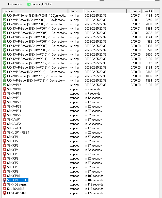

    Posted Feb 25, 2022 04:51 PM
      |   view attached
    Hi ,
    Thank you for your feedback. I have tried exactly the steps you have requested but still of no luck.
    2022-02-25 22:19:36,645 Thread-14 [TRACE] NOLOGIN/- NOUI [com.uc4.ecc.framework.core.aetracing.AutomationEngineTraceListener] - Starting: Opening connection to <hostname>/<IP Address>:8433
    2022-02-25 22:19:36,645 Thread-14 [TRACE] NOLOGIN/- NOUI [com.uc4.ecc.framework.core.aetracing.AutomationEngineTraceListener] - Loading certificates from directory: 'D:\certs'.
    2022-02-25 22:19:36,660 Thread-14 [TRACE] NOLOGIN/- NOUI [com.uc4.ecc.framework.core.aetracing.AutomationEngineTraceListener] - Certificate loaded from file 'D:\certs\automic-sbx.der'.
    2022-02-25 22:19:36,660 Thread-14 [TRACE] NOLOGIN/- NOUI [com.uc4.ecc.framework.core.aetracing.AutomationEngineTraceListener] - adding 90 certificates from the default trust manager
    2022-02-25 22:19:36,723 Thread-14 [TRACE] NOLOGIN/- NOUI [com.uc4.ecc.framework.core.aetracing.AutomationEngineTraceListener] - WebSocketClient started.
    2022-02-25 22:19:38,823 Thread-14 [TRACE] NOLOGIN/- NOUI [com.uc4.ecc.framework.core.aetracing.AutomationEngineTraceListener] - WebSocketClient has no more active sessions and will shut down.
    2022-02-25 22:19:38,823 Thread-14 [TRACE] NOLOGIN/- NOUI [com.uc4.ecc.framework.core.aetracing.AutomationEngineTraceListener] - WebSocketClient stopped.
    i started the work processes as you have suggested with a gap of 5 seconds .
    I'm attaching the JCP logs here.
    Any idea here please?
    Regards
    Vimalan
