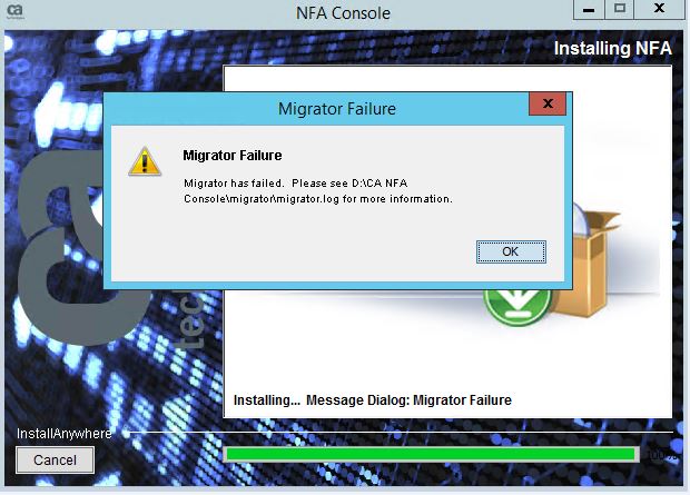

    Because it marks me error when installing version 9.3.8 of NFA. as migration I need to start from a version below to
    install that version.
    I look for the log on the route and I do not.

    Is this a fresh install of a migration/upgrade ?
    Check below , looks similar to your error
    https://comm.support.ca.com/kb/my-9-3-8-console-upgrade-fails-with-migrator-failure-message/KB000072626
    Below article has some helpful tips
    Tech Tip: NFA 9.3.8/9.5 Upgrade Path and Tips

    Make sure the error in that doc matches the exact error in your migrator log. If you are unsure, please upload your migrator.log from D:/CA/NFA/migrator/.

    the problem is that the installation path can not be different between the harveste and the NFA console..
    The solution was to put as path D: / CA / NFA
