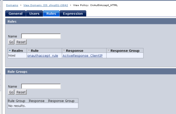

Step 1: Create an active response as shown below :
Step 2 : Configure the Active Response with either OnAuthAccept or OnAccessAccept rule.
