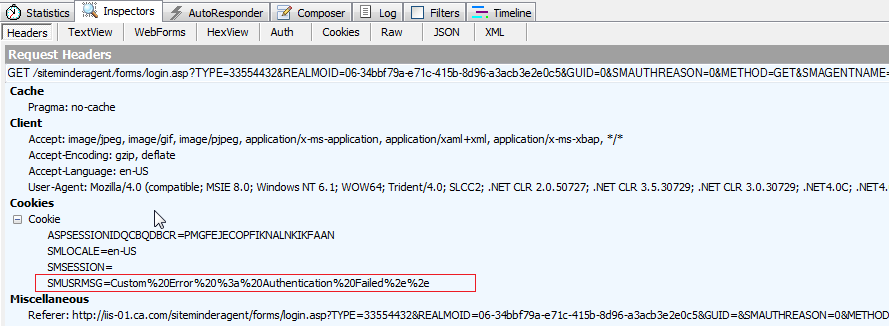

Testing:
  • Sample CustomErrorMessage.java - Sample Custom Authentication scheme
  • login.asp - Sample custom login page
  • Fiddler.saz - sample http header capture from the testing
