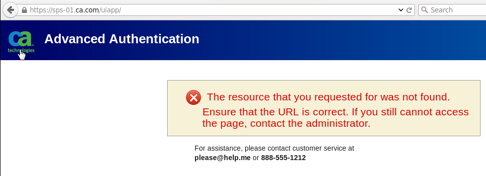

  • Ensure "CA Advanced Authentication Flow Application" ( Advanced Authentication ) service is up and running on the CA Single Sign-On CA Access Gateway Server.
This could be verified by accessing following URL :
https://<CA_Access_Gateway_Server_FQDN>:<SSL_PORT>/uiapp/
You should get a page similar to below. (Ignore the error, as it is just indicating that the required parameter is not being passed)

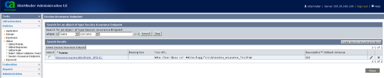

  • Create Enhanced Session Assurance end points
    From Administrative UI, click Policies-->Global-->Session Assurance Endpoints.

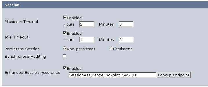

  • Add Session Assurance End Point to your realm
     Note : For Session Assurance to work it is NOT necessary to enable Persistent Session on the realm.
