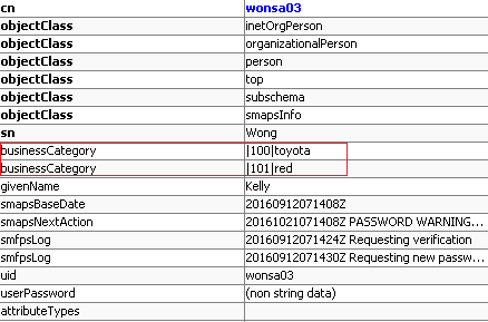

              1. User Directory Configuration
                   Store question number and the answer to be used during Forgot Password verify stage in any user attribute
                   exactly as shown below:
                        In the screen above, the user attribute 'businessCategory' is being used for storing the Question ID and the
                        corresponding answer for that question.

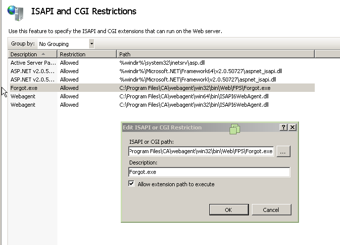

               3. Web Server Configuration (For illustration purpose, we will use IIS 7.5 web server)
Define a virtual CGI directory for the directory that contains the FPS CGI Program
      • Open IIS Manager ( type "inetmgr.exe" in the Run window and click enter)
      • Right Click on the Default Web Site and select Add Virtual Directory option. The virtual directory wizard opens.
                                  Specify as following :
                                  Alias : FPS
                                  Physical path : <Web_Agent_Installation_Directory>\win32\bin\Web\FPS
      • Click Ok
Add ISAPI and CGI Restrictions for FPS CGI
      • Open IIS Manager and navigate to the server level.
      • Double Click on ISAPI and CGI Restrictions
      • From the Action menu click "Add" to add new restrictions
ISAPI or CGI path: <Web_Agent_Installation_Directory>\win32\bin\Web\FPS\Forgot.exe
Description : Forgot.exe
      • Click Ok

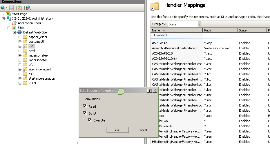

Edit Feature Permissions for the Handler Mappings Feature for FPS Virtual Directory
      • Open IIS Manager and navigate to the FPS virtual directory level.
      • In the Features View , double click Handler Mappings.
      • In the Actions pane, click Edit Feature Permissions.
      • In the Edit Feature Permissions dialog box, do the following:
Select Read
Select Scripts
Select Execute
      • Click Ok

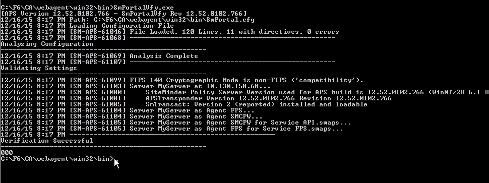

      • Validate SmPortal.cfg configuration using the SmPortalVfy.exe tool located at<Web_Agent_Installation_Directory>\win32\bin folder. It should state the verification as successful as below :

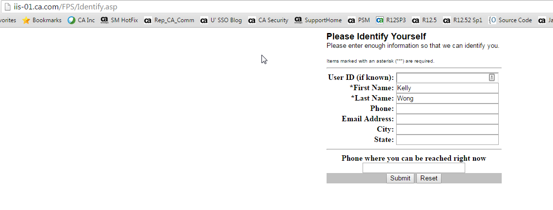

1. Access FPS interface
    e.g. http://<server.domain.com>/FPS/forgot.exe

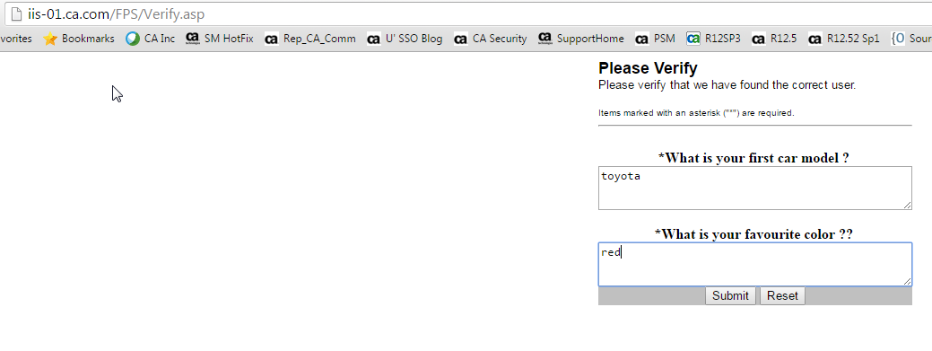

2. Provide Required Fields and optional fields as necessary and click Submit.
3. Once the user look up is successful using the provided user information, the user will be prompted to verify with Question and Answer

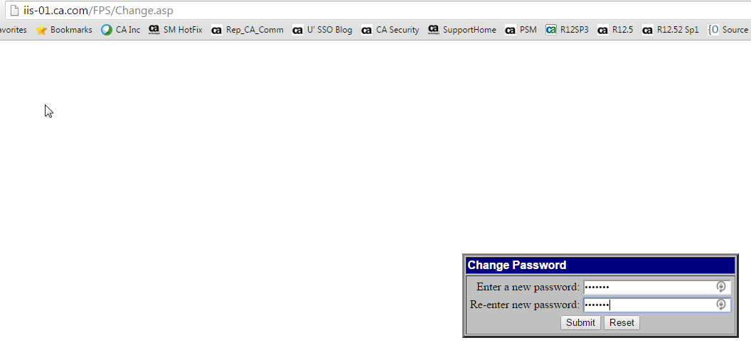

4. Upon confirmation of the question/answer, the user will finally be prompted to change his/her password

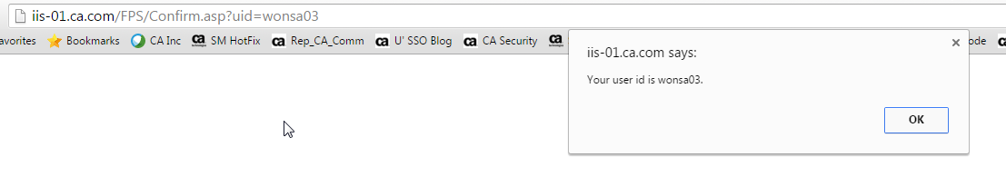

5. In the confirmation screen, the information related to the user is displayed as below:

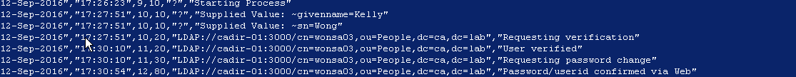

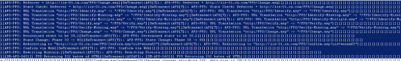

Sample policy server trace log with the FPS tracing turned on :
Sample FPS Audit log (FPS.log) :
